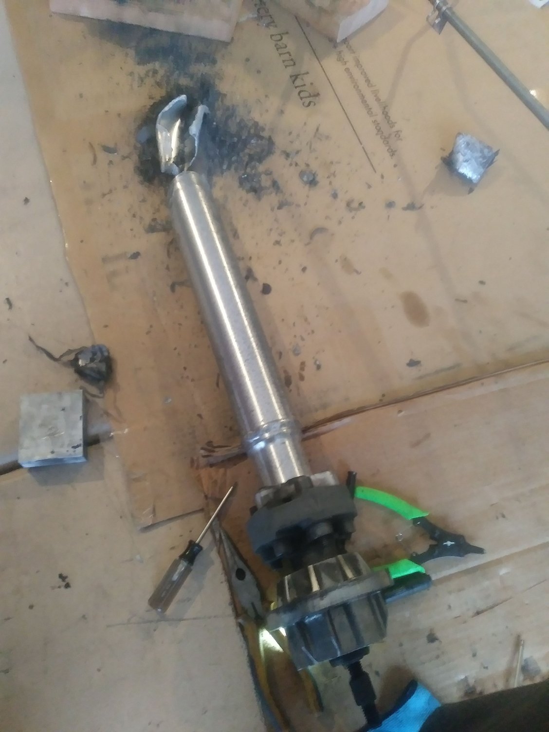

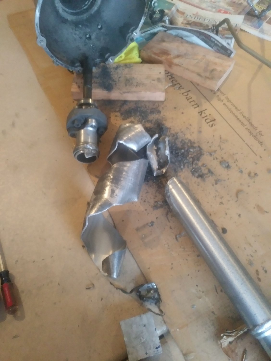

Can some one please tell me if a 2008 Z06 torque tube assembly will fit/work on a 2011 GS. If not why? And if not can parts be swapped to make it work? And I mean like the pinions. I recently destroyed my driveshaft and found a nice 08 assembly but after doing some reading I'm concerned its a no go and really wanted some confirmation. Yes its a 6 speed. Thank you so much!

I found this that only mentions different lengths for different years, not the different models. I would bet z06 vs non-z06 are the same length. Hopefully someone else knows for sure
https://www.corvetteforum.com/forums...be-length.html
C6 Manual Torque Tubes
05-08 = 54 3/4"
09-12 = 55 3/4"
