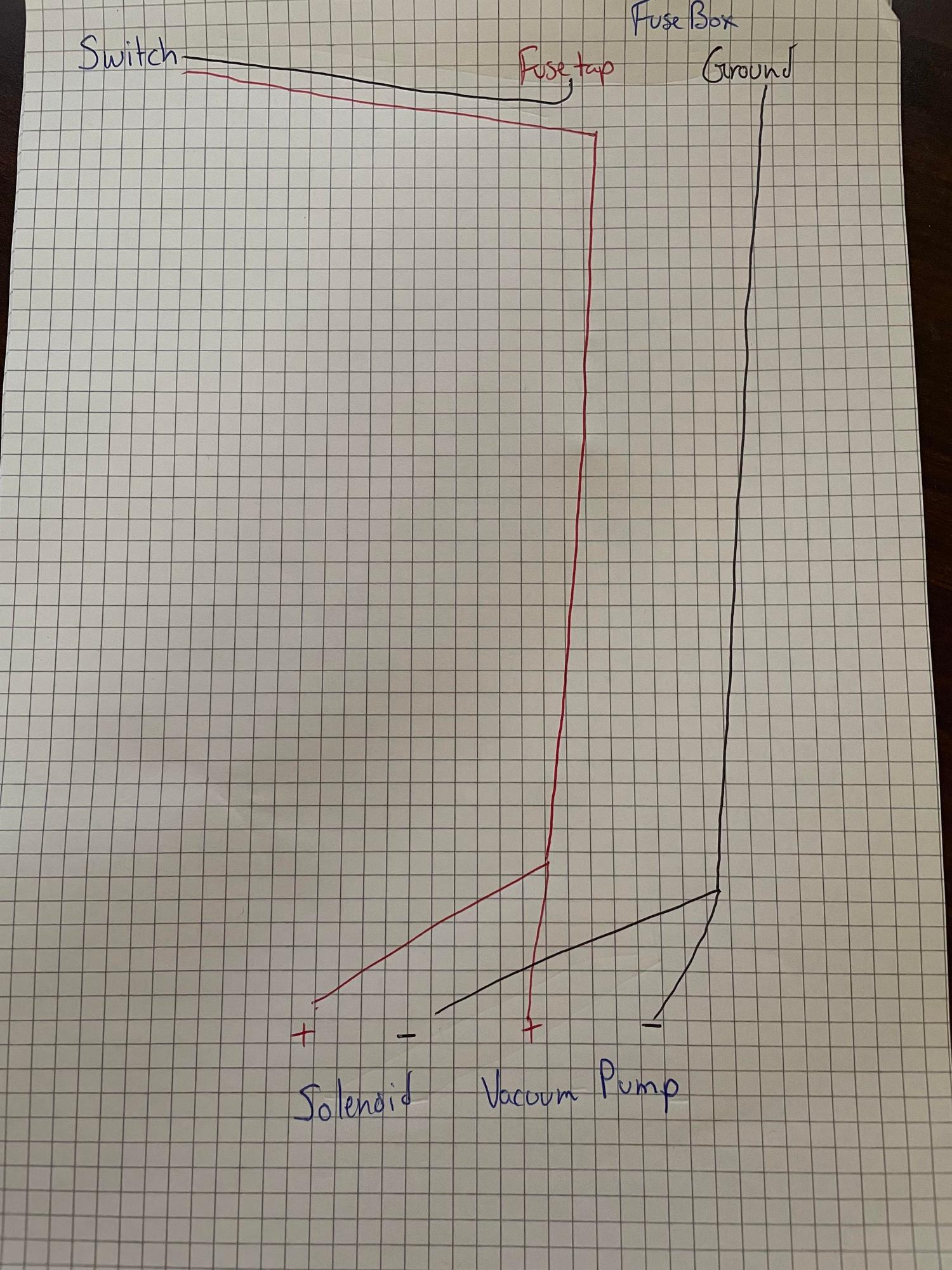

I realize this is an old thread but with fairly recent comments, I wanted to ask how the folks who used this DIY method over standard NPP in a box liked it. Any issues?
I have been reading all sorts of posts about the NPP function and M2W. I think I understand the main differences between stock bi-mode/NPP vs removing the NPP fuse for those that had NPP option from factory vs adding M2W for those who had stock NPP vs NPP in a box for those who added NPP exhausts to cars that did.not come with NPP from factory, and finally vs the DIY method in this post.
I actually think I would prefer the stock NPP which only opens the valves when load is at level where vacuum from motor decreases (around 3500 rpm generally). That avoids drone in highway at low rpm for those who choose to remove the fuse and/or have not installed a manual controller.
Since I did not have NPP from factory, but now have bi mode exhausts, the only way to remove highway low rpm drone is to install NPP in a box or this DIY method which uses an external vacuum pump. I think NPP in a box is simpler since all parts and instructions are included. But this DIY method is appealing since it avoids vacuum tapping at rear of intake manifold and the required routing vacuum lines through length of car to the back.
Can someone explain how the manual switch is connected? I presume it is attached to the solenoid but the write up does not explain. The NPP in a box uses the vacuum from motor so I assume that control box is just the solenoid and remote control parts all rolled into one. The M2W option for OEM NPP also uses the fuse box to control the OEM solenoid.
So does this DIY method also require the manual switch to be connected at the fuse box? If so, how? Would the switch not be able to be connected directly to the solenoid in trunk and only serve to complete the circuit in either on or off position without the need for power source?

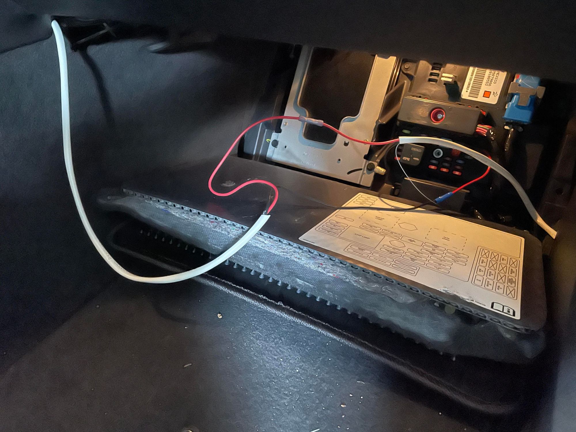

Hopefully the pics below will clarify the wiring. The switch is wired inline on the positive leg. I used 14awg sheathed speaker wire. For simplicity the leg going to the switch uses black and red wires, but it is POSITIVE.
My car did not have NPP from the factory. I like the functionality of this system and being able to keep it in stealth mode at WOT. I am planning to relocate the switch to the ashtray area when I get around to it.
I didnt want to mess with tapping into engine vacuum and running vacuum lines under the car. I found it easier to run the electric wires through the cabin and install the pump/solenoid in the rear.. that's my opinion and preference.

Likes: 40
Thank you. Exactly what I needed. I agree with everything you said.
I will set up with regular switch first. But one idea I am.playing with is whether there is a way to code a switch that can be run using the BT button on the steering wheel. I am picking up a steering wheel that has those buttons.
