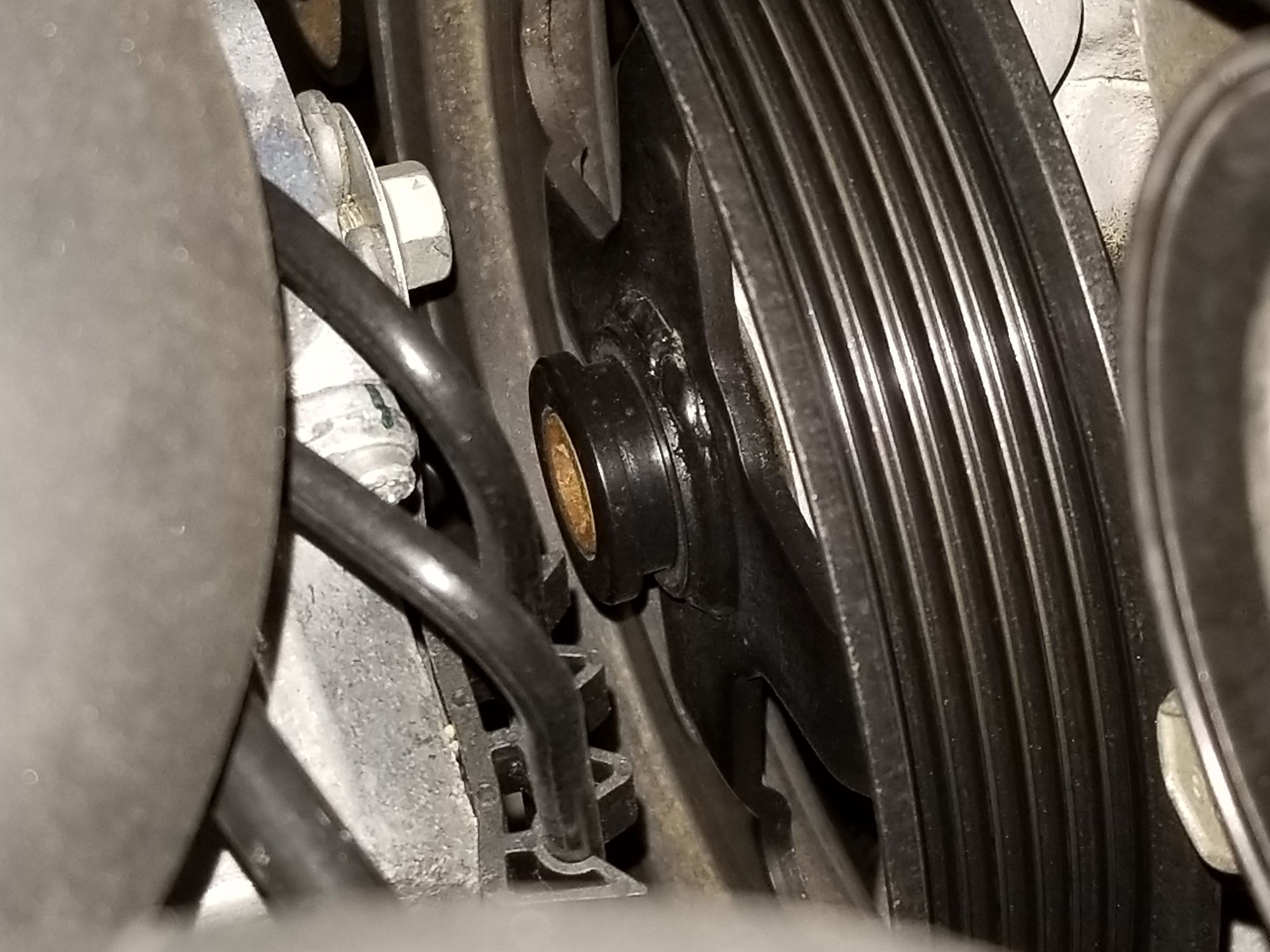

Hey guys, I have a LS2 Corvette and it is making a whining noise. It is a high pitched whine and seems to be louder when I turn the wheel. The steering rack has been replaced (was leaking anyway) and the noise did not go away.so I assume it is the pump (correct me if you think it could be something else).
First, are you guys pretty sure it is the pump as well?

See if your pulley is backing off the snout on the pump. One guy had that issue. If it is, maybe have someone reseat it for you. But, it's possible it will happen again down the road.
I would have expected that to cause more of a belt squeaking sound, but maybe not. Is there a good way of checking it?

Just look at it. The pulley should be flush with the snout.

It it does not look like to me that the pulley is misaligned.
