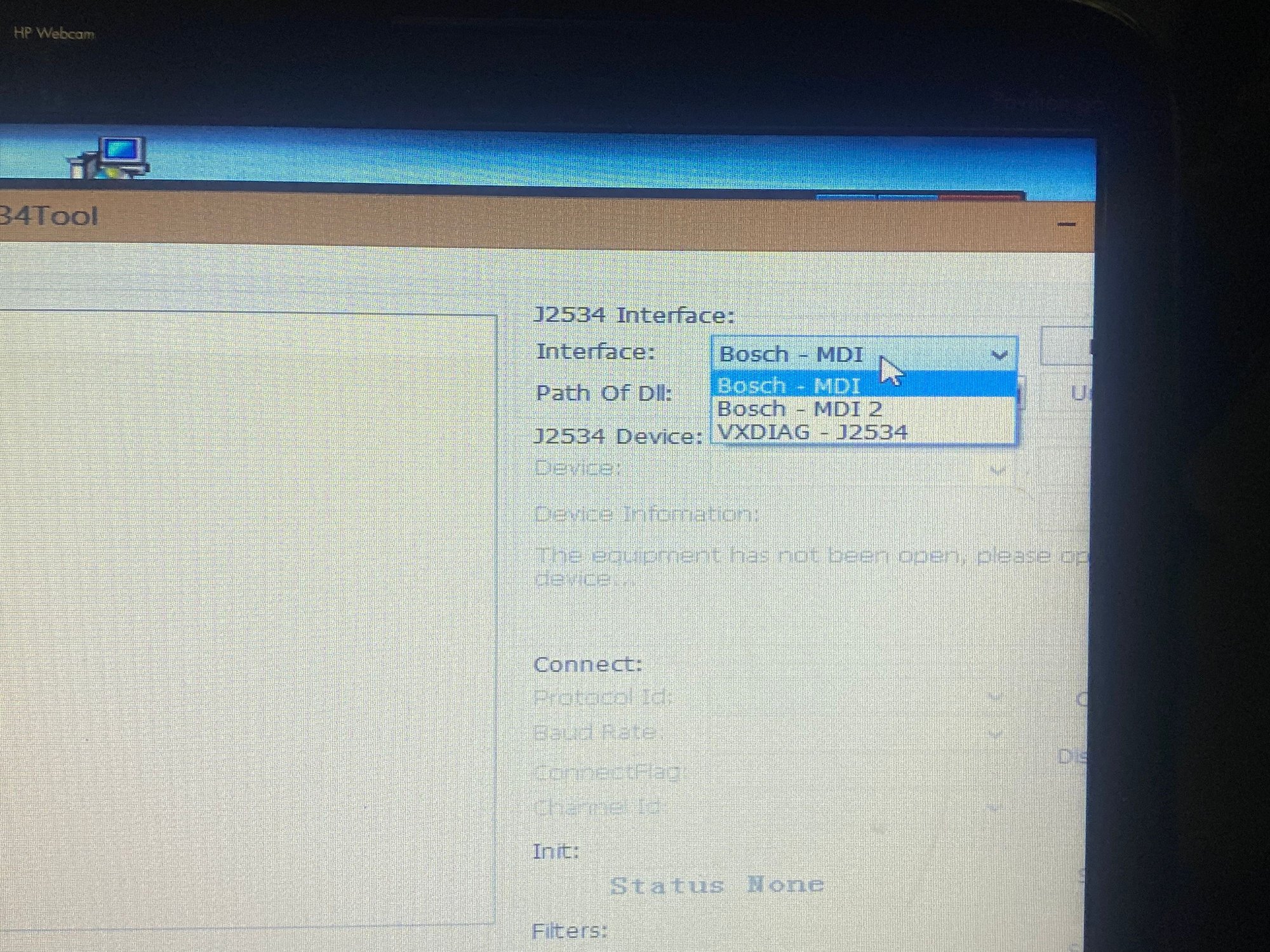

Sorry for bringing up this post. But I am new to all this and I’ve followed the instructions to setting this up and I’m having an issue in the passthru menus. GM Tech 2 is not appearing in the interface options. I’ve reinstalled many times many different ways and It is still not working. Could anyone help me out with this?
What program are you running?.

Dano523....i am getting the exact same 3 options on my interface as well....i am only after the tech2win part of the software but have down loaded multiple times and installed but it never is an option ....so when i start the tech2win it just goes right into the program and never ask's for the "mdi" option or the "usb nano" option
what am i missing?

i guess the tech2win software is not seeing anything from the VX manager?

Load VX manager first, then click on liscence and fimware to update the nano in VX manager with Nano plugged into the machine.
Now leave the nano plugged in, VX manager still open, and now install Tech2win. Hence VX manager with nano attached has to be open, so the Tech2 win program will be able to over write a few files in the VX manager program. Also, the quick start T2w icon on the desk top, delete it, since your never going to use it.
Now go back into VX manager, go to apps, and install pass through, T2w/gds, and SGM RDS.
Now do shut down the laptop and restart it. Now when you click on the tech2win on desktop, should get a pop up, select north america, next pop up, select MDI 1, then last pop up window, select the usb device in that list.
Now tech2wiin should finish loading to get the blue tech2win screen.
If no pop ups, then you installed wrong, and if you have xv manager seeing the nano, its firmware is updated, and liscence is currrently, then reinistall Tech2win again, and make sure Nano is plugged in, and VX manager is open.

Dano523
i believe i now know what the problem is....i have been trying to install this on a surface pro 5 for what seems like 100 times.....it always never finds the nano in the tech2win program.....i think there is some sort of issue with the com port configuration on the surface that wont allow it ????
i dug out an old dinosaur laptop i have and loaded it all on there and boom first time it's up and working.....thanks for all the help but i sure wish i could find a way to install it on the surface pro... the surface is a lot smaller....if anyone ever figures out how to make that work on one i'd sure be interested in how it was achieved
thank you again for the help and direction!!!
