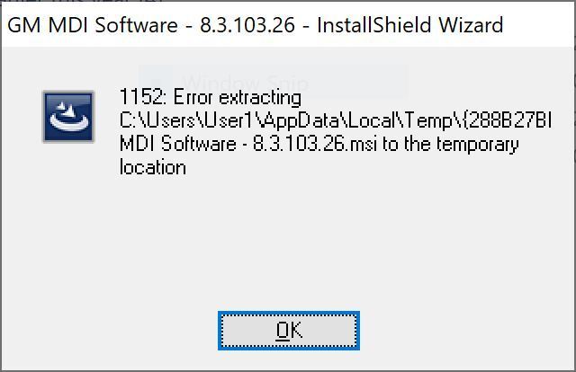

Dano/All,
I bought the recommended wired Tech2 off of Amazon.
Step 1 - Load the Device
Question, does that mean connect the VCXNANO device via the USB cable? I assume yes.
Step 2 - Execute MDI
When I go to the following folder I find MDI.exe
D:\Tech2Win
I also tried running the auto install routine and my anti-virus software deleted a trojan file.
FYI, I'm running a Win10 64bit laptop.
Anybody got any ideas how I can proceed?
Thanks,
Dave

Just a FYI, but the autoinstall.exe will install all the needed software for the nano.
Hence MDI from that install in not going to work, since the Nano uses a different set of drivers.
As for making MDI and it select menu work as Swad point out, only need for the MDI clone that looks like this,
But with that clone, whole different story trying to get cracked Tech2win to work with it, since the cracked tech2win is really looking for the Nano instead.
