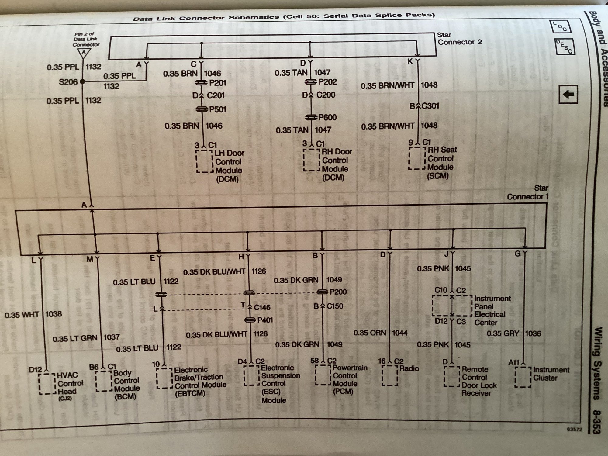

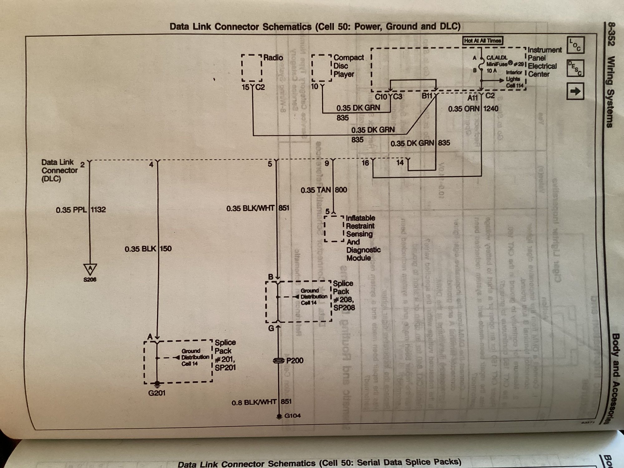

I have a 98 convertible and a 01 cluster, so now I can’t read out the airbag codes because the 98 SRS control module uses a separate custom OBD2 pin (pin 9) to put out diagnostic data, instead of the shared bus, and only the old cluster was able to read that. I had the vx nano and successfully installed the tech2win on a windows 10 pro, worked fine except the body supplementary inflation restraint item still showed no comm.
I’m starting to wonder if the real tech2 even has that readout, I thought the vx was pretty much a full fledged copy.

Yes, full copy in regards to Tech2win, just cracked so you don't have to get the subscription threw GM.
As for the 01 cluster in the 98, should have flashed in fine with TIS2000 SPS to start with to the car, short of changing the mileage on the cluster, which will take a VCI file download to do that. If not sps flashed yet, will not be sharing the correct BCM vin secuirty number, and why you may have the problem.
As for SRS, have taken a look at the schematics for the different years to see if an addition wire need to be run?
C5 diagrams,
http://www.tuningconcepts.com/Cars/C...2%20WIRING.pdf

Shows the 98 SDM bus is distinct from the common serial bus.
How on earth the 98 cluster is supposed to read it is beyond me because I don’t see it having any serial input other than the same A11 pin as in the 2002 diagram, according to my 98 preliminary shop manual.
But if it was a cluster programming issue, then I wouldn’t be getting the exact same no communication to SDM message as on the vx tech2win, unless the tech2 cannot read the early SDM either, ie it doesn’t read pin 9 of obd2.
Finally, is the SDM dead maybe? I did the whole diagnosis proc and it didn’t tell me to replace the SDM. I got a 4V voltage on the dlc bus pin 9. Also I plugged in a replacement SDM unit to see, no difference. The airbag light went on ever since I replaced the steering wheel clock spring, which supposedly triggers a code in the SDM that has to be cleared.
can I just connect the two wires, pin 2 and 9 on the obd, to manually add the SDM to the common bus? If I recall serial bus is supposed to handle message collision

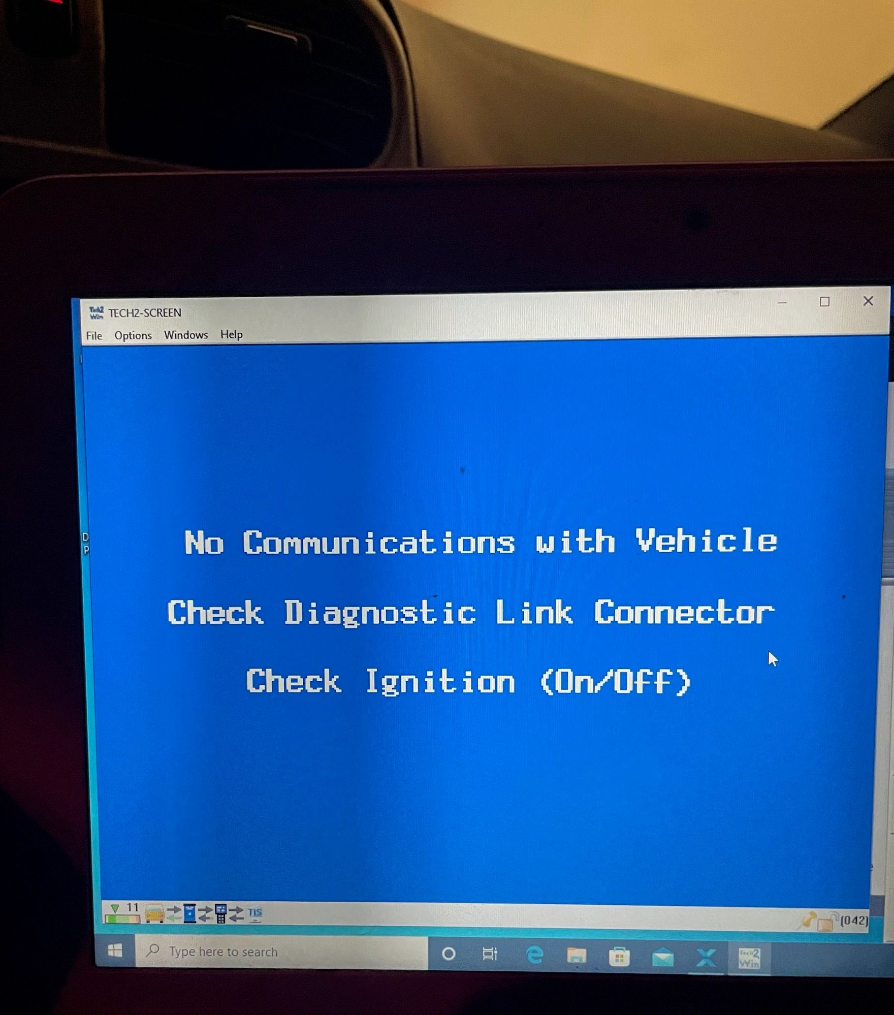

Help! Why am I receiving this message?
Attempting to turn the F55 shocks to the OFF setting
Maybe I'm in the wrong mode but...I pressed/ held the ACC for 10 seconds; Car powered on without the engine starting.
Am I doing something wrong?
Vehicle: 2005 Corvette
OS: Windows 10 64 bit
Connection: USB Cable

classof05,
Send me a PM (click on my name) with phone number and will give you a call to talk you through the problem/solution.
My guess, did not set up vx manager and its apps correctly to start with, or not selecting the correct items in the 3 pop up screens after you click on the tech2win icons, before you get to the Tech2 win screen.
Hence first pop up, north america,
Second pop up, MDI 1
third, USB device listed in it.
Short of that, and everything is right,
the only other thing that comes to mind, is locked aftermarket tune, and that is a nasty road to go down, if don't know who the tuner is, to get them to unlock it so factory tech2 can hand shake with the car.

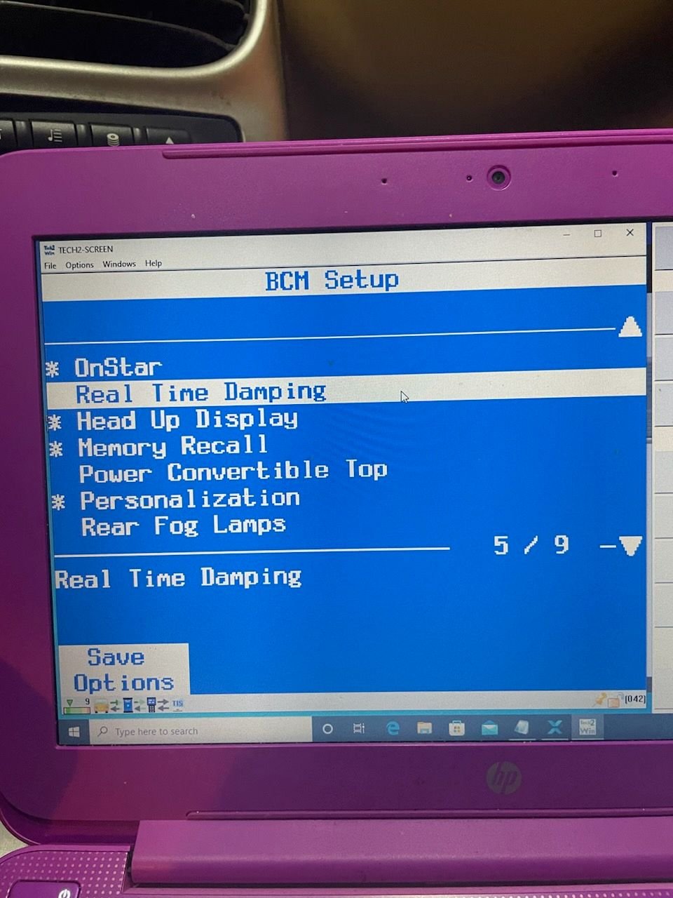

Thanks for reaching out, Dano!
I was able to get it to connect to the vehicle this time around.
1. Placed the car in ON position
2. Plugged the VXDiag up to the laptop/car
3. Ran both programs: VX and Tech2
Was able to turn the Real Time Dampening OFF:
To Help With VXdiag
