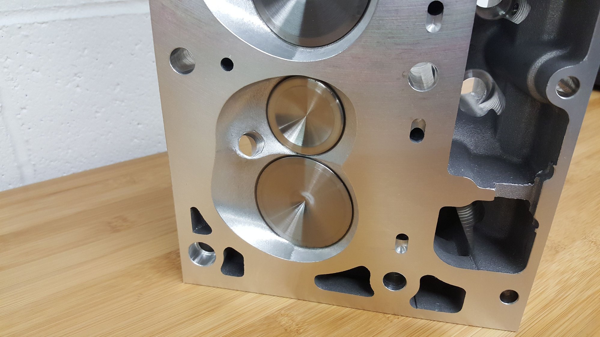

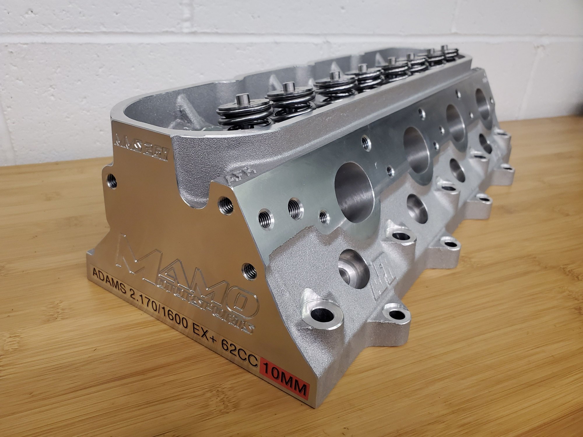

Stock LS3 heads come with an as cast 260 cc intake port that flows 315 - 320 CFM.....and around 220 CFM on the exhaust. The numbers aren't bad but they are very inefficient (the port is on the big side)
My aftermarket clean sheet design is a 12 degree head utilizing the AFR LS3 castings which I designed back in 2014 just before my departure there and the launch of Mamo Motorsports.
The LS3 product I offer now is an improved version of that design (my MMS 26X head) and it has a finished CNC ported volume which is the exact same size as a factory as cast LS3 head (260 cc's) but flows a whopping 390 CFM!!
Besides the gains in peak volume (70 CFM) think about the gains in airspeed that creates getting all that additional flow thru the same size port.....that does amazing things for throttle response as well as power and torque output
The exhaust is very impressive also with a 50+ CFM gain over stock (272 CFM versus 220 CFM!)
PM, email or shoot me a call and we can discuss in more detail, but in the meantime here are some cylinder head **** shots of what we are discussing
