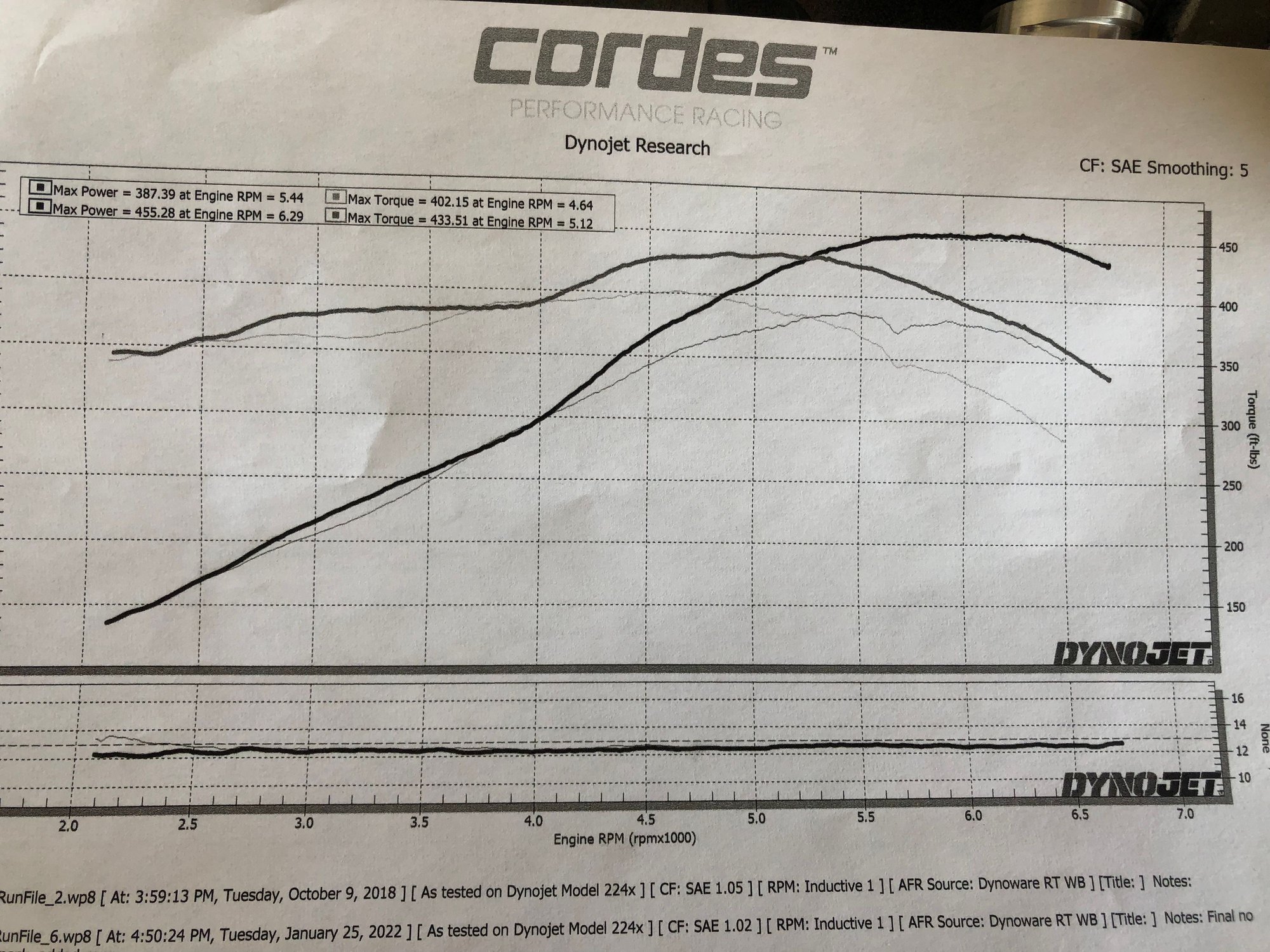

Here you go gentlemen. There are two results on here, one from when I just had headers and a tune(2018), second on Jan 2022 is with the above cam (TSP). Also I’m running an A6.

Your results are almost identical to my BTR Stage 2 cam.A6 transmisiion also.

455 on an A6 is a good result. It does appear to be peaking at 6000 or so but it's flatted out over a few 100 rpm. The reason for this is that the cam is peaking low with the intake manifold peaking at 6300. The result is the power having the 2 peaks holding it flat. If the advance was changed to be 114+1 with a bump in static compression, the result would be a strong peak at 6300 and the same torque from compression rather than the advance. Its a good compromise.
It looks like a good daily driver cam.
With a 3200 stall, it would likely run a great 0-60 time.
Are the heads stock?

Yes heads are stock and I’m thinking my next upgrade would be heads and converter. Yes great daily driver and wherever I go I get compliments on how it sounds (ARHeaders, hi flow cats x pipe and Corsa extreme) I do have a Soler TB and cai also.
