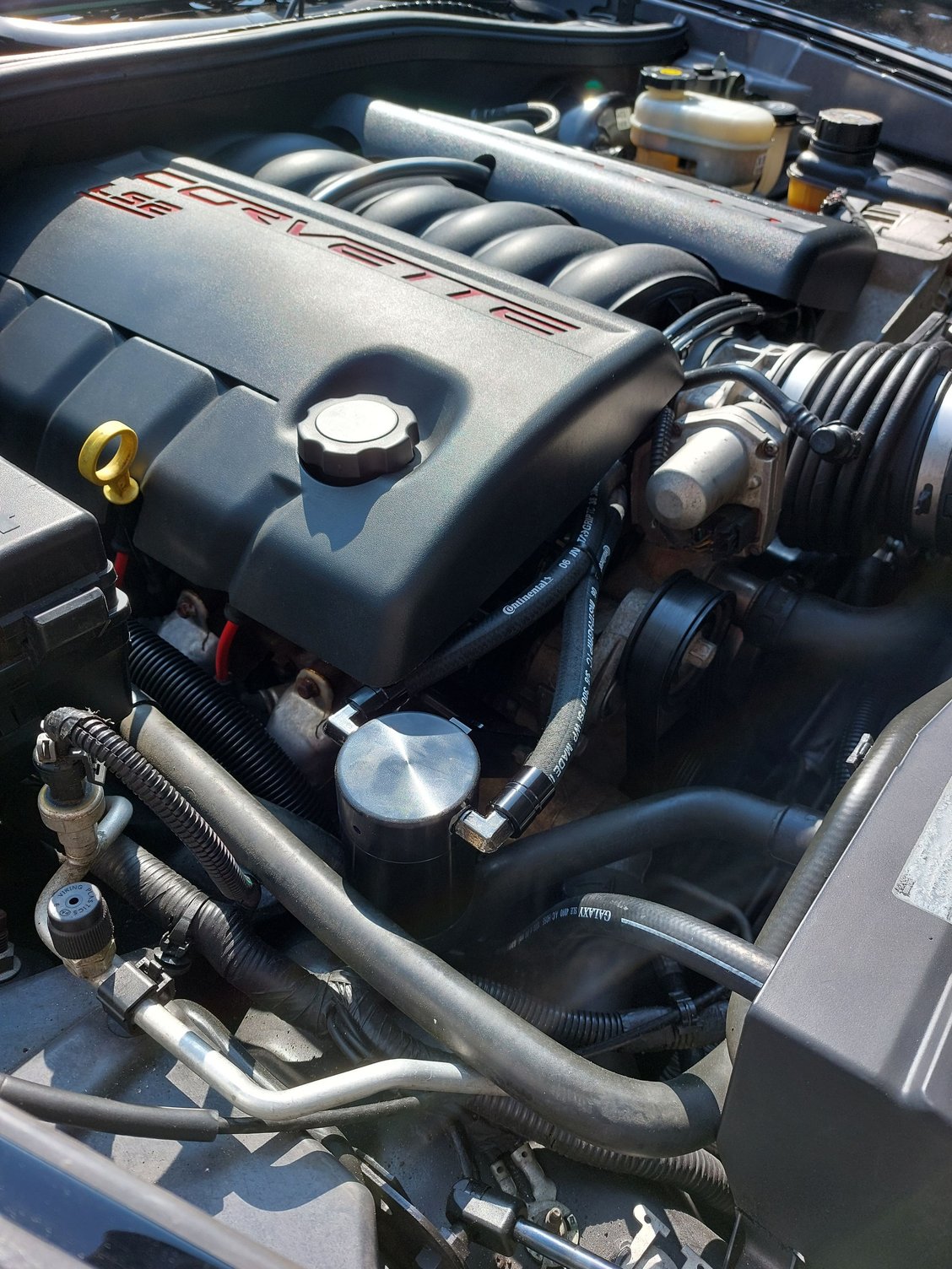

Sorry about that, thought the pictures uploaded on the previous post. As you can see, without my custom bracket it would just be a pain to get to and the can would be sitting on coolant lines.
Old Jul 22, 2023 | 03:30 PM
So the bracket that extends from the can attaches to an existing bolt hole? Or, are you attaching to some other thing?
I used the existing hole on the cylinder head with the bolt they supply you, I just placed a small bracket(Metal bracket with 2 holes on top that I had laying around) so the can sits higher and then extended it with a long metal spacer and 6" bolt/nut,

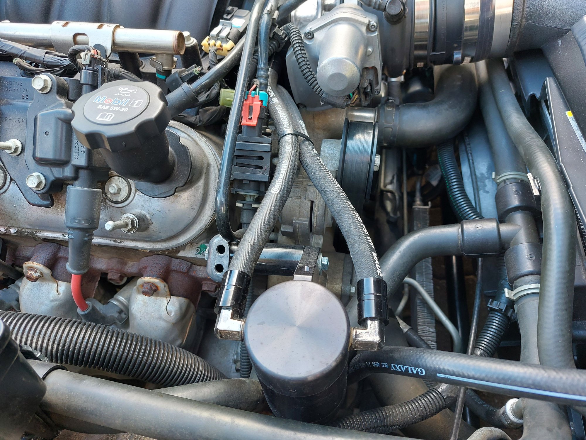

I discovered the catch can shown in this post. Saw it on Ebay. It comes with a mount for the Corvette LS engines. Here is the Ebay listing for this can. I will likely pull the trigger on this one.
That's the can I bought, modified the bracket to work on my LS2. This is after about 24 pulls on the dyno, and a half tank of gas of street driving:
My can arrived and I am looking for AN fittings. Question about a couple of things:
  1. How long is the stand off you are using to position the can away from the head?
  2. Are you using a ball valve to drain the can?
1. I used a long 6 Inch bolt inside that black metal spacer, the bracket bolts to the head and the 6" spacer bolts to that (About an 1 inch higher)
2. No ball valve, I extended the can so it's easy to unscrew and drain without removing anything.
