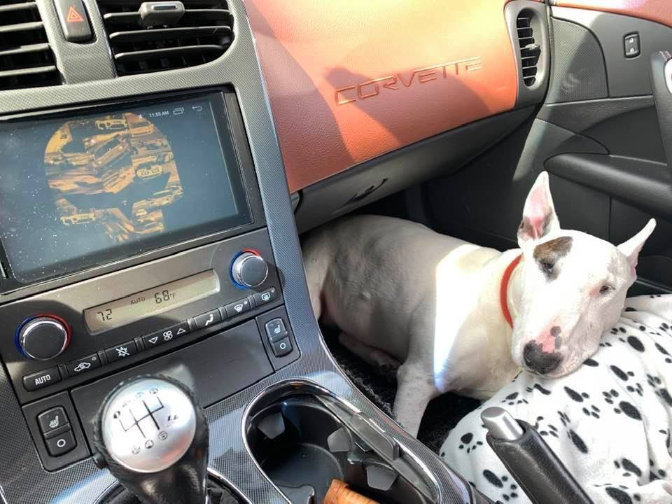

I gave mine away for FREE, and like many others, updated to a modern head unit (and I never even listen to music in this car...just LS7).
Lightyears ahead with cameras, carplay, etc, etc
the sole downside was a bit of glare in certain conditions but that was easily resolved with an anti-glare screen.
