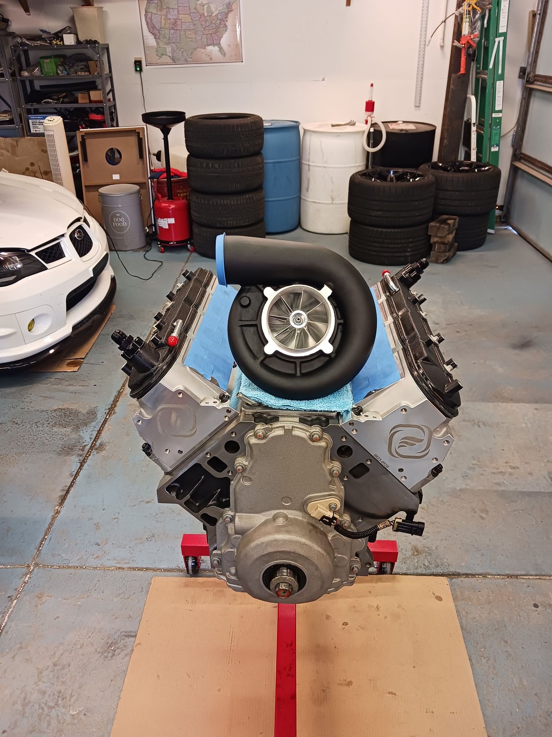

I've decided to do a 2 port catch can setup. Each port will be vented from the valve covers. I will be using 2 passenger side valve covers, remove the oil fill caps, and replaced with baffled caps to then run to the catch can. Catch can will either be vented to atmosphere or run into exhaust for venturi, I haven't decided that yet. Then I'll connect the valley cover port to each of the two valve cover OEM ports to just help equalize things. Catch can lines will be large -10 lines. Here is a picture to help visualize.

I did two -10AN for my setup as well.
