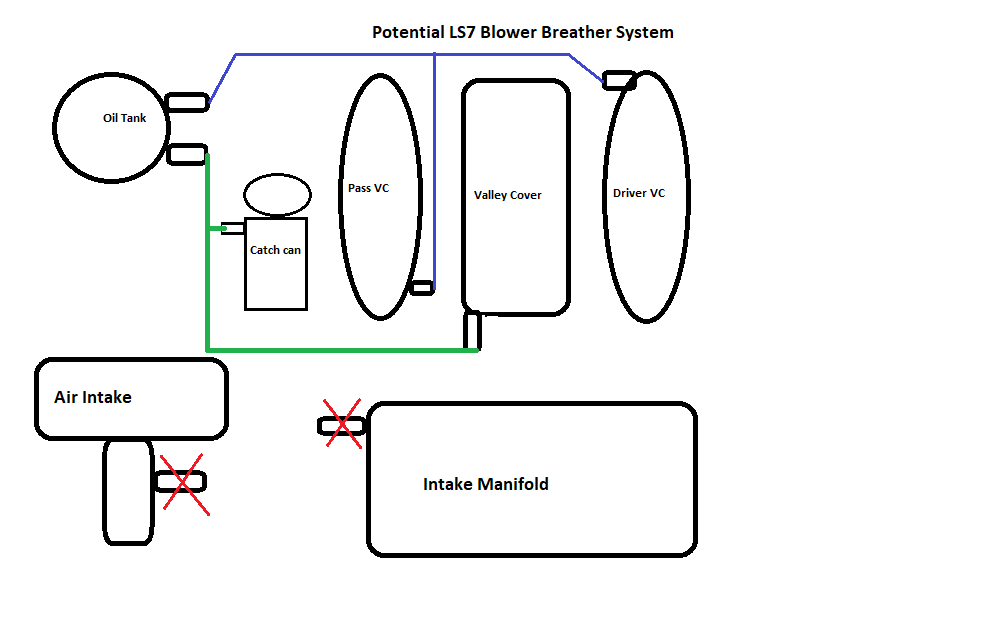

Hi, adding a blower to a built 427 and would like to keep as much of the emissions crap as possible out of the intake and blower. I have had success in the past venting to atmosphere on boosted applications. I realize there would be no vacuum to pull out gasses, but at least my intake will remain clean. Even catch cans can and will put some gasses and residue into the intake if plumbed that way. I just prefer to not do that and vent to atmosphere. Below is the OEM setup and then a potential solution for me and would like to get the groups thoughts on if there would be any issues with the second image setup. It's basically eliminating the dirty side and then venting the oil tank vs plumbing back into the intake. I'm also considering running a hose to a bung welded in the exhaust in place of the breather filter on top of the catch can to help pull some air. Thanks for any and all feedback.

No, since without vacumn to the system when the motor is not on boost, going to cause the engine oil to get dirty really quick.
As for when on boost, going to be more blow by past the rings, to over pressure the PVC dry side lines if that is all that is in play.
So valley port stays in play with catch can, one way valve so boost is not lost out the intake port under presssure, and catch can get valved blow off filter so when the valley port is pushing lot of blow by pressure under boost, it has someone to go out of the catch can.
If you are not going to run the fuel rail covers, then can pull the blocker cap off the passenger rocker cover, to add in a vavle blow off filtered device there.
As for clean side, think Elite oil separate to replace the oil tank cap, which will keep the oil from reaching the intake, instead of using the catch can PVC port.

I do have another car that is vented to atmosphere and the oil life is fantastic. Looks almost new at 2500 miles, that's about when I change it since its non-synthetic. I'm not too worried about the lack of vacuum when not in boost, if I need to, I will change oil more often, but I think the oil will remain very clean just like my other car on 30psi.
When in boost, I'm hoping to keep blowby to a minimum as I won't be hitting too high of pressure, maybe 15psi, and I have gas ported rings to help with ring seal. That said, over pressurizing the valve cover lines is one of my concerns.
About the catch can at the valley cover, I tried that on the car with it NA. Still got oily residue into the intake. Even if a catch can keeps all of the oily residue out, there will still be gross gasses coming back into the intake, which is what I want to avoid. I would rather have a little higher crankcase pressure than nasty, incombustible gasses being pushed back into the intake.

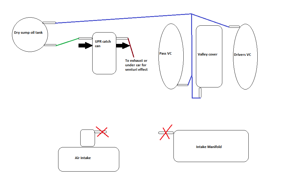

Or maybe this would be a little better for a little more venting, keeping the valley cover port in play.

Both valve covers merge together into one (Y fitting) larger line, then that line tees into the valley cover, with yet a larger line exiting last into the bottle. Sorry, no pics. With a blower, I do think you could benefit from some crankcase vacuum. This might be a great place for a header evac setup. Have you given any thought to adding some fittings to the collectors? Then run some combination lines to the valve and valley covers. I urge you to use valve covers with some sort of baffling. This setup would give maximum vacuum at WOT, where you'll need it most. However, if youre running cats, you'll have to hook this setup up after the cats, or you'll probably plug them fairly quickly. Hope this helps........
So if I'm understanding correctly, you have nothing going to the dry sump tank? Both ports capped on it?
I've thought about the exhaust yes, or just a hose unning along the bottom of the car so as im driving i get the same effect from air moving under the car.
No cats, oem valve covers with good baffling.

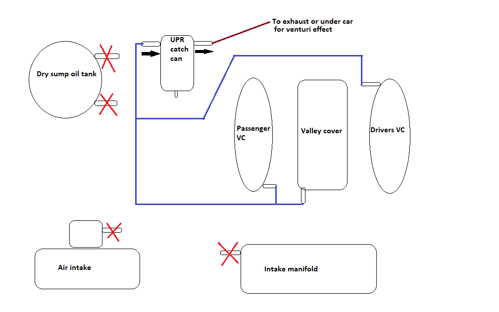

Maybe something like this?

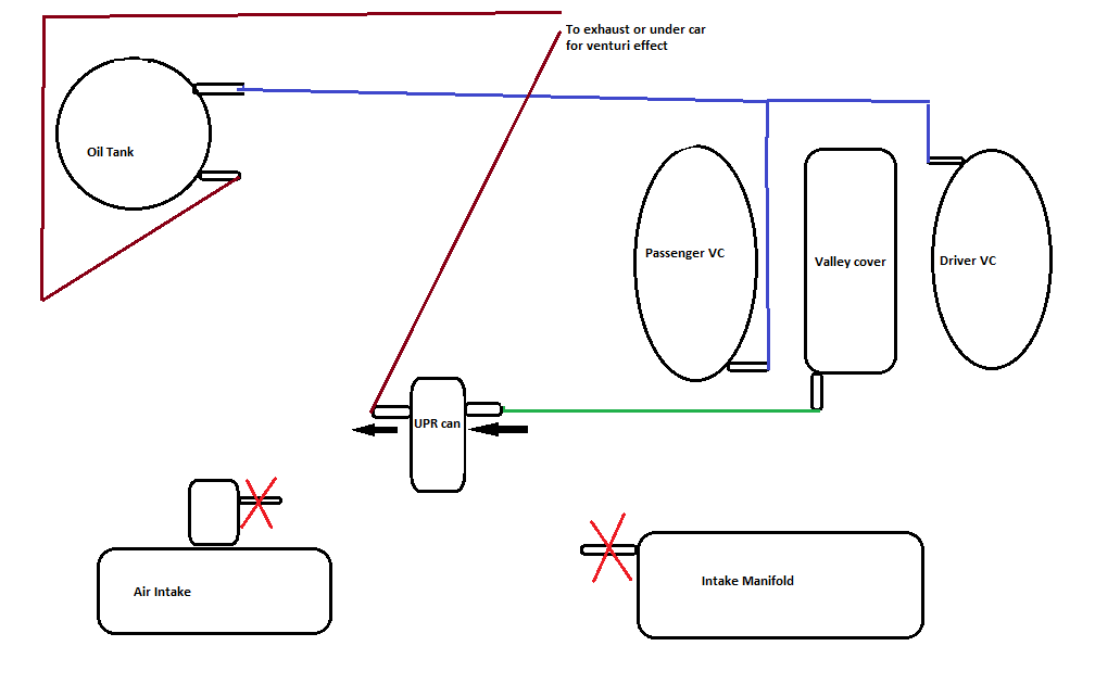

Or...

Probably do this as I can sort of use the oil tank as a second catch can.

Final answer....I think....for now anyway lol
