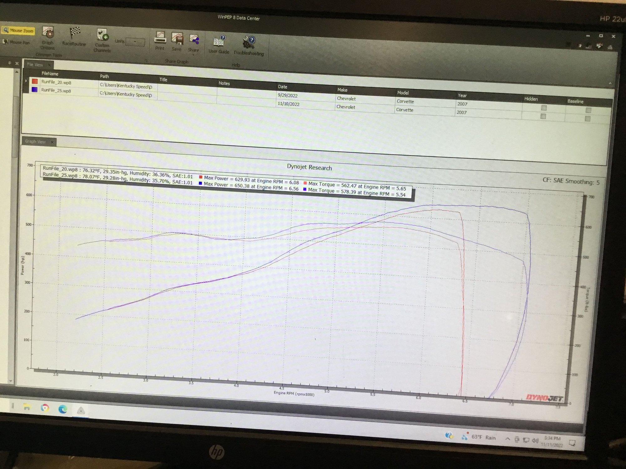

Originally Posted by PMPerformance
humor me, is there any proof that there is any huge detriment to 1 3/4? Other than maybe a 3-5hp lower gains across the board than 1 7/8
let me humor you with this dyno sheet
stock MSD intake and ARH 1 7/8 headers vs
ported MSD intake and ARH 2” headers on a 450 cid
if I was buying headers for a Ls 3 and was looking for performance I would buy 1 7/8”
that my opinion
there plenty data out about headers on Ls 3 ,its your money I could have saved a lot of money .
if I would’ve bought right the first time
i would say the 2” headers =10hp
that my opinion
you woulda saved me money? What would the smaller headers have done with the extra 1000rpms the bigger ones had?
You ported and Intake, upgraded headers and ran it out another 1k rpms. Of course it made more power up top
