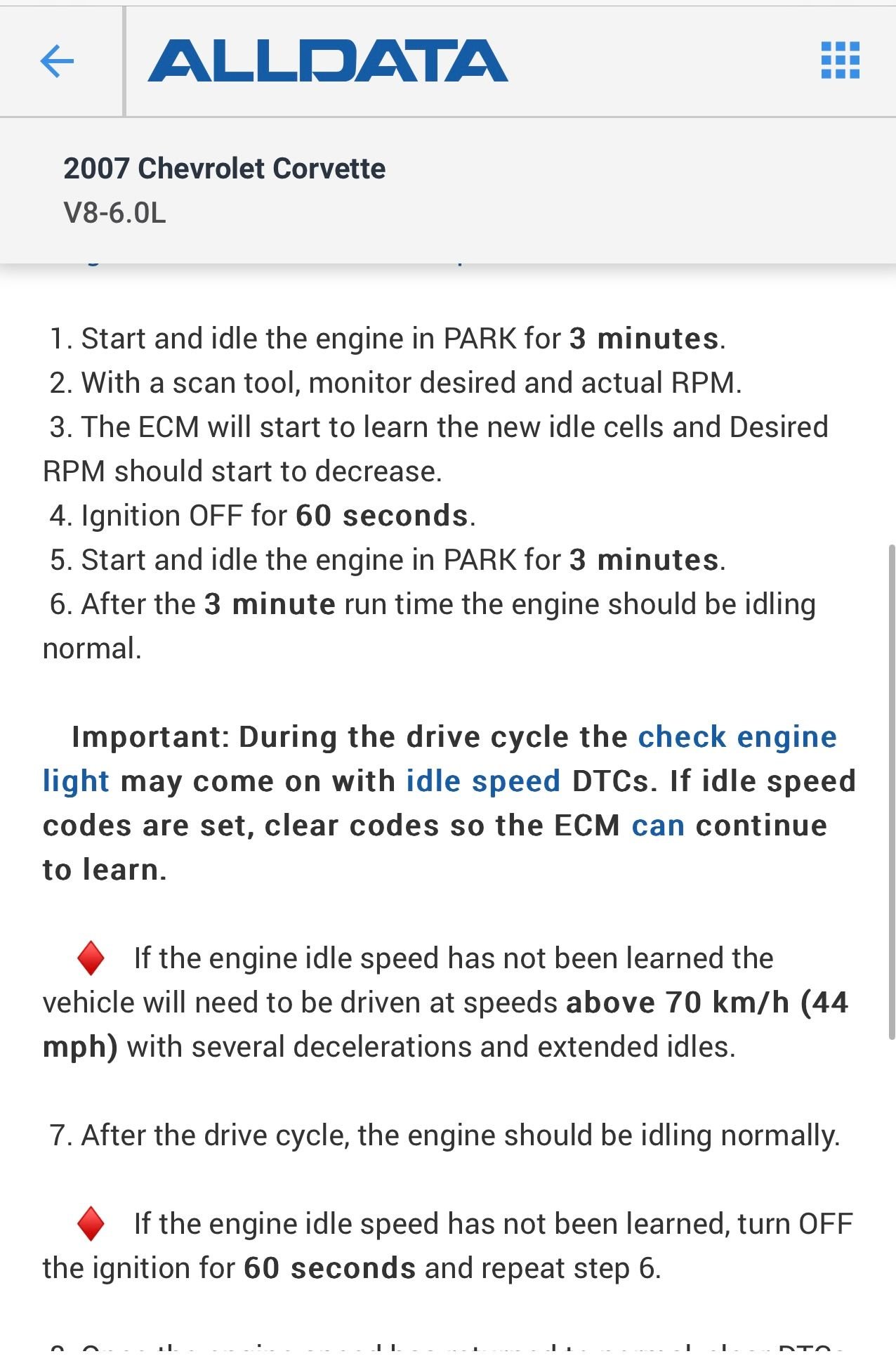

May need to go through a throttle relearn procedure. See information contained in the attached post, worth a try. Also, the shop should have informed you of any needed relearn steps, as most of the newer electronically controlled cars require the same.
https://www.corvetteforum.com/forums...and-reset.html
Good luck...GD

Is the TPS sensor that was replaced OEM or aftermarket ??…trouble codes are not part numbers !!…an idle learn should be done !!
