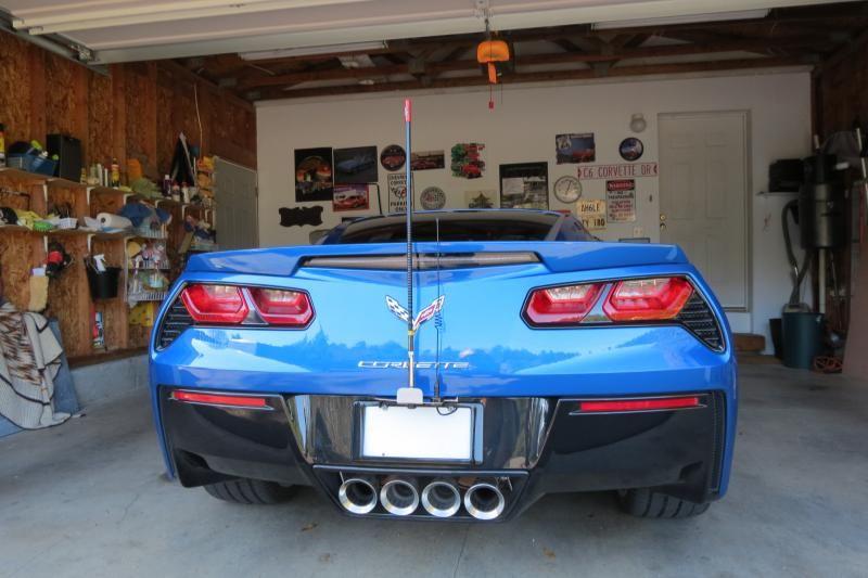

Originally Posted by KenHorse
I've run 2 antenna cables back in my C7 and the answer to your question is no.
What I did was to remove the rear inside trim (I have a Z51 and I'm referring to the plastic trim that encloses the sub woofer and amp along the rear edge of the hatch (trunk) area.)
One that's removed, you can drill a hole just large enough to pass the RG-58/U coax through (1/4"). But first, you need a snake (a wire coat hanger will suffice) and you need to push it through the hole, DOWN towards the license plate. You need the snake because the shock-absorbing "bumpers" are quite a pain to get cables past.
Once you have the snake through one of the holes near the top of the license plate mounting, attach a string as a messenger cable and pull it back up through the hole into the truck. Finally, attach your coax and pull the messenger back down to the license plate area.
Here's how mine turned out:
Oh yea.. your CB antenna is a non ground plane type, right?

My gawd man, that's absolutely hideous! Kinda looks like the shopping carts in Ross!
Which is why the CB antenna uses a quick disconnect so it's only in place when it needs to be
And when it needs to be it looks hideous!
