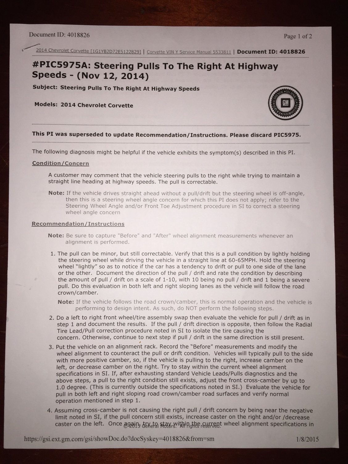

There is a bulletin about this:
Originally Posted by ETHYL
I had the same problem of steering pulls to the right at highway speeds. I took it to the dealer and was aware of this problem and showed me a GM PI that addresses this problem.
It's #PIC5975A: Steering Pulls To The Right At Highway Speeds shown below.

Zymurgy beat me to it, I saw that bulletin last year . Is it possible that in all your visits the dealer never checked for service bulletins and PI's?

I have the same issue-pulls to the right.
I took in to dealer for alignment and showed them the bulletin. They did alignment and charged me about $125. It didn't fix the issue.

unless you set up the cross caster way out of specs, it will pull right. I had mine aligned and it still goes right, but I did not have the cross caster put out of spec as per the bulletin, tire wear is more important, and the cross caster will cause tire wear. It is fine to me, as at least it takes you away from oncoming traffic, I do notice that when the road is crowned to the left I go straight or slightly left, just hyper sensitive to the crown on the road.

Sounds like they're pushing the wheel alignment to the limits (or slightly beyond) to compensate for something else being out-of-whack. I'd sure like to know what that something else is.
The tolerances achievable with modern manufacturing methods permit some manufacturers to produce cars with no provisions for adjusting caster or camber, leaving toe-in as the only available adjustment. These cars rarely have alignment problems as long as the bushings are in good shape and nothing gets damaged, and they don't pull to one side when going down the highway.
The fact that the bulletin specifically mentions pulling to the right as a symptom is odd. I'd bet they know what's REALLY wrong, but just don't want to pay for fixing it. So, the owner is going to pay for it with increased tire wear and/or reduced handling performance.
