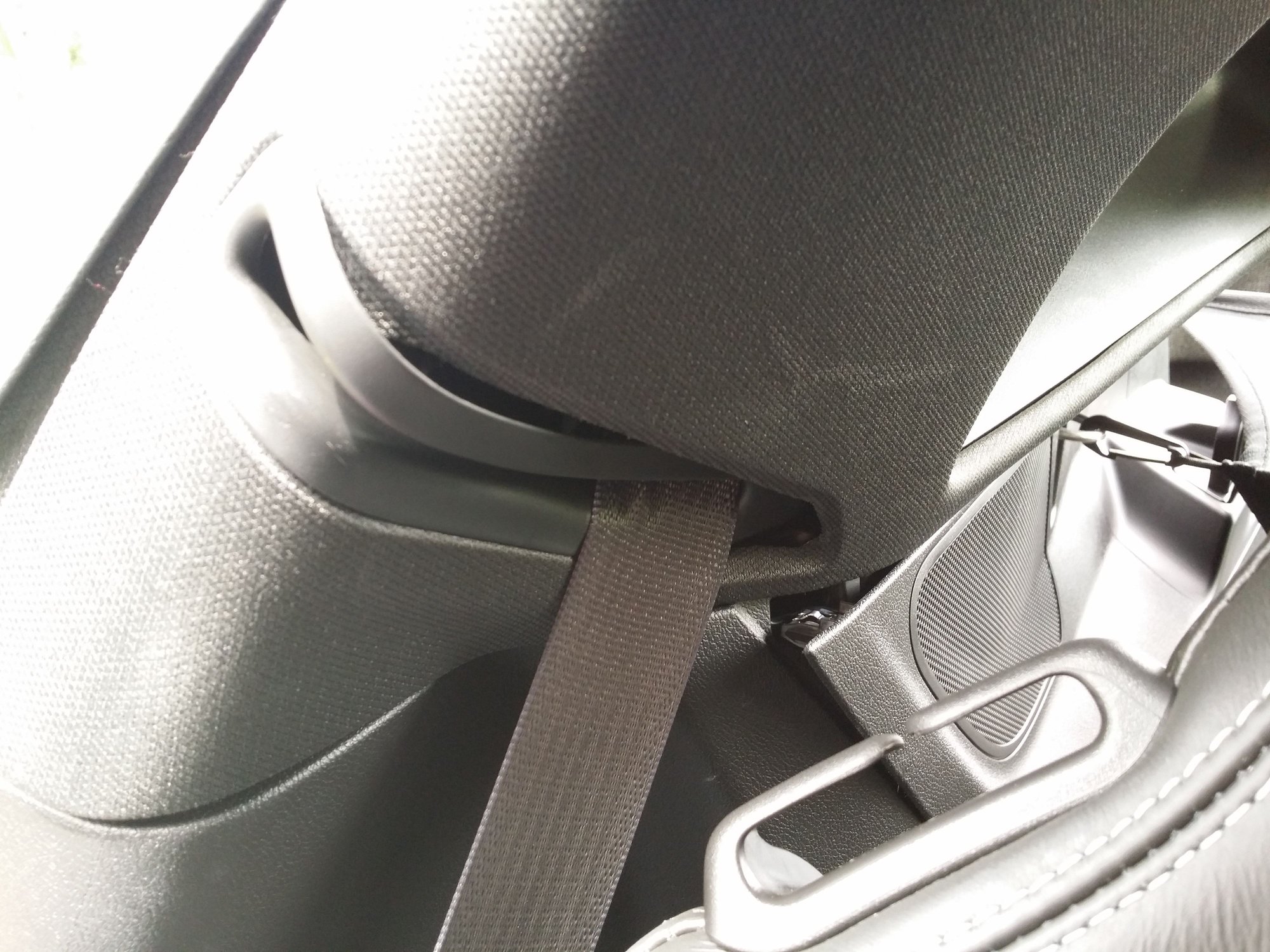

System is acting like the air bag deployed, and I believe it tried. During the initial hit the inside of the car filed with smoke or a powder of some sort. The passenger side Seatbelt cinched so tight that it pulled the metal clip into the side of the plastic on the seat and cut into it. There's a gap difference between the top and both A-pillars. Behind the drivers door the gap is off compared to the passenger side. The hood is cracked and the front fender gaps are off also. The passenger side Seatbelt pulled so hard that it strained the panels behind it and popped them out. I was going 76 mph when the collision occurred.

The passenger side Seatbelt is so tight that it has a twang to it when you touch it. The drivers side won't retract or come out at all either. The Display is telling me too have the air bag serviced.

I haven't ever been in an accident with seat belt on but from the looks of the seat belt assy I wonder if that kind of damage to the seat belt guides and retainers would maybe cause you additional injury, I'll continue to wear mine though, just thinking out loud............
I think they retract to a certain resistance or just a given length of belt regardless how much belt us pulled out.
I learned from a recent accident that once the tensioners do their thing the belt must be replaced. Only good for one accident
2013 and up belts have a explosive charge in the tensioner
That tightens belt upon impact. Look to be pretty powerful.....
