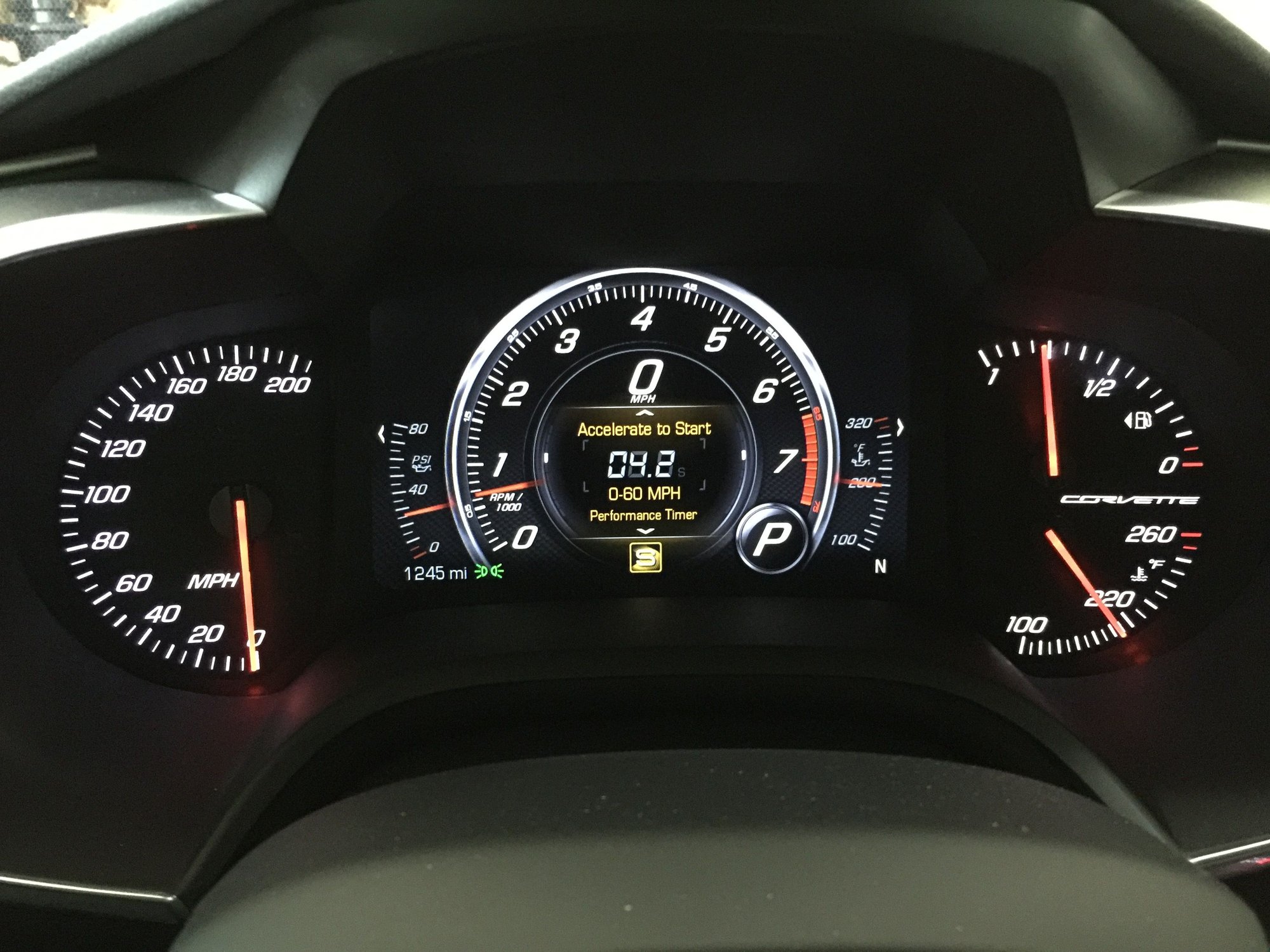

0 TO 60 Timer is now shown and operational. Is all I have is a case #8-1774583817. The dealer could not offer any other information? They said it was done through GM Engineering?
Did you notice any ill side effects, or everything seems to work properly after the update?

No it took 2 weeks for GM engineering to figure it out it went all the way to GM Engineering the actual Program writers. I was told yesterday that the Android update was not available? Did you get the update?? I will call back today.

The more I read about this, the more I am convinced the lack of the timer was a programming error which was missed and later corrected.
I hope engineering puts out a TSB on this. When I take my car out of winter storage I would like to go to the dealer once for the Android Auto update and the timer update.

So now that I'm past the 500 mile break-in and oil change, I tried using the 0-60 performance timer today on my December built 2016 Z51. Although the timer is present, I was unable to set either the start or end speeds, and no reading was recorded. Does anyone else with a recent build have the 0-60 timer present, but that does not function?
Note, I do not have a lap timer function in the menu either.
