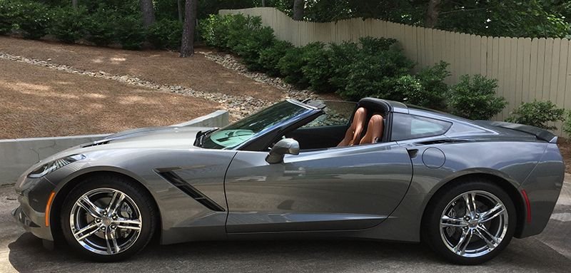

Hi folks. Finally traded my 2001 Coupe for a 2016 version. The chrome stingray badge on the sides breaks up and hurts the design for me. I'm thinking of removing it using dental floss and a solvent, like I removed the body side moldings on my 91. Has anyone done this? If so are there any caveats (like a hole to locate the badge) I should watch out for?
Photoshop with/without attached. Color is Shark Grey.
Thank you for your help. GM
Without.
With badge.

Nope, a heat gun and some directed force will pull it right off. Double-side tape is all that holds it on. Check my sig pic.

There are no holes to worry about. Dental floss or heavy fishing line will do the trick. You may want to apply some gentle heat to the area (such as with a blow dryer) before the operation; doing so will soften the adhesive and make it easier to remove all of it. WD40 works well in removing lingering adhesive residue.

Does look nice and clean with it removed.
