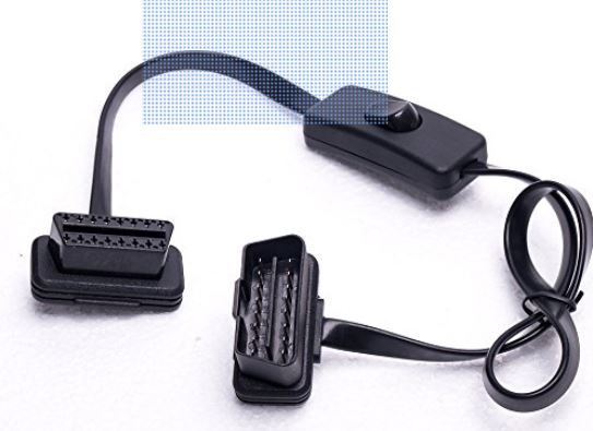

Don't know but I went ahead and ordered a Range disabler after getting assurances from the company that their latest firmware is compatible with 2017 model year.
Old Jan 10, 2017 | 10:51 AM
  #207
joemessman's Avatar
joemessman
Joined: Nov 2015
Posts: 7,382
Likes: 3,501
Glad you are up and running. Since you bought the AFM range extender, you might consider this extension to turn it off and on when not driving. It will drain your battery if not driving the car for a few days.
https://www.amazon.com/gp/product/B0...?ie=UTF8&psc=1
Old Jan 10, 2017 | 11:50 AM
  #208
KrikGS's Avatar
KrikGS
Joined: Oct 2016
Posts: 101
Likes: 88
Thanks for the link! I'm going to try it as is for a bit since this is my daily driver.
