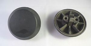

Here's what happened to one of the plastic jacking pucks installed on my C7. Almost caused the same damage to my rocker panel, fender, etc. as the OP......
That could only have been caused by a metal jack lift pad like this, which dug into and cracked the puck.

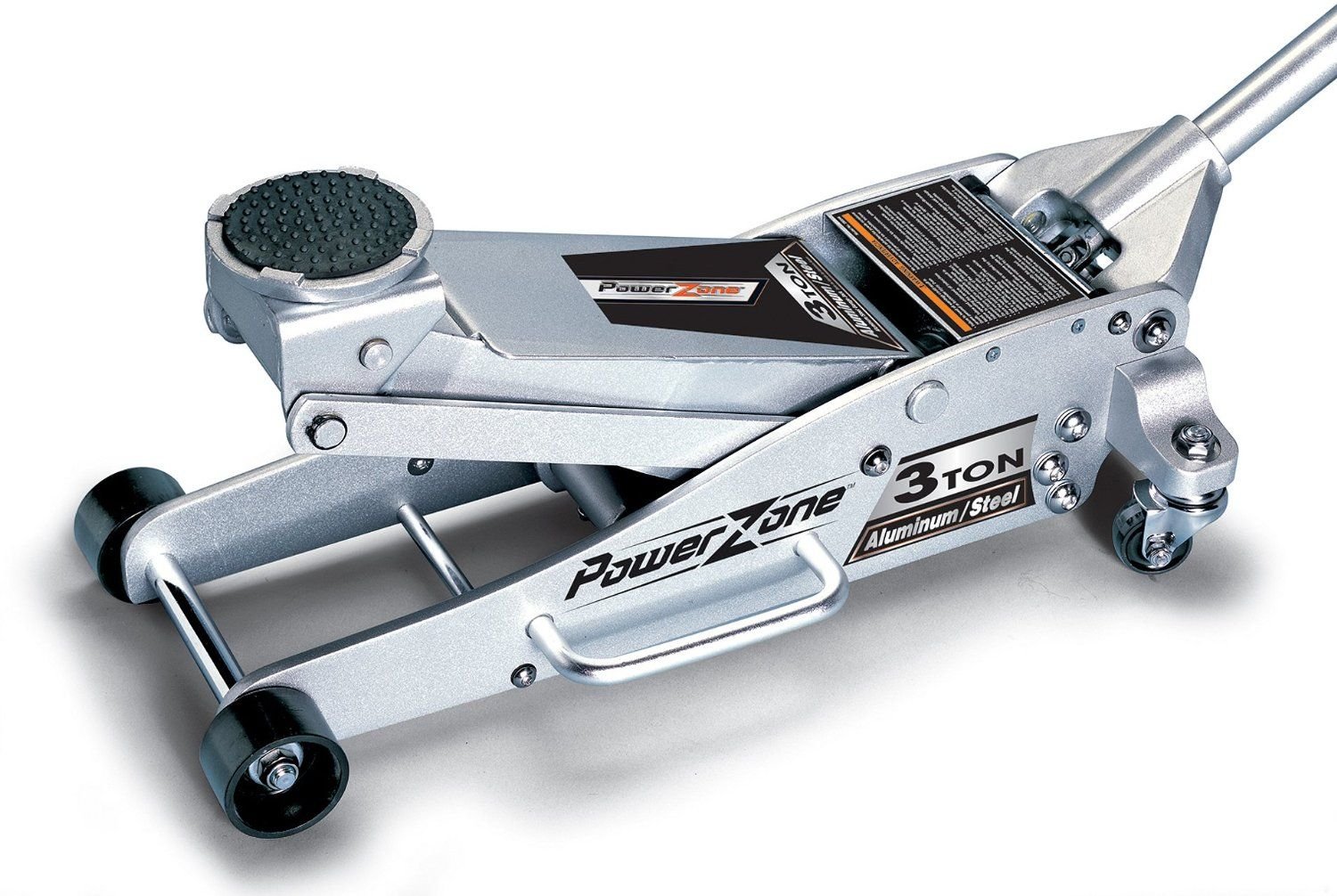

What you should be using with plastic, leave-in jacking pucks is a large flat rubber pad like this:
You gotta use the correct tools for every job.

What you should be using with jacking pucks is a large flat rubber pad like this:
Personally, I wouldn't use the above jack as I want a jack with a saddle that has a steel lip so as the puck will be contained in the saddle and not allowing a chance for the puck to slip off the saddle as the jack moves during the jacking process.

Kevin, I was referring to the leave-in plastic pucks, the poster (#119) showed a picture of shattered. That's what I prefer and use over the type in your picture. Put that type of steel lip saddle on a plastic leave-in puck, and it's like sawing through it.
However, you're right for your type of puck, that style steel saddle is probably best . . . right tools for the job again, and that's why they have different jack lifting point designs.

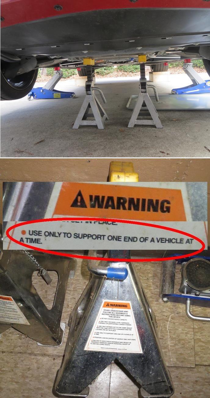

Yep and jack stands ONLY on one end of the car!
Note Warning Label On One Pair of Mt Jack Stands
Latest Lifting Points From 2016 Service Manual

...the leave-in hard plastic jacking pucks are less than $50, and coupled with a proper floor jack with rubber lifting pad, make it virtually impossible for a vehicle to fall off the jack.
Foosh, do you recommend a particular brand / model of those pucks?

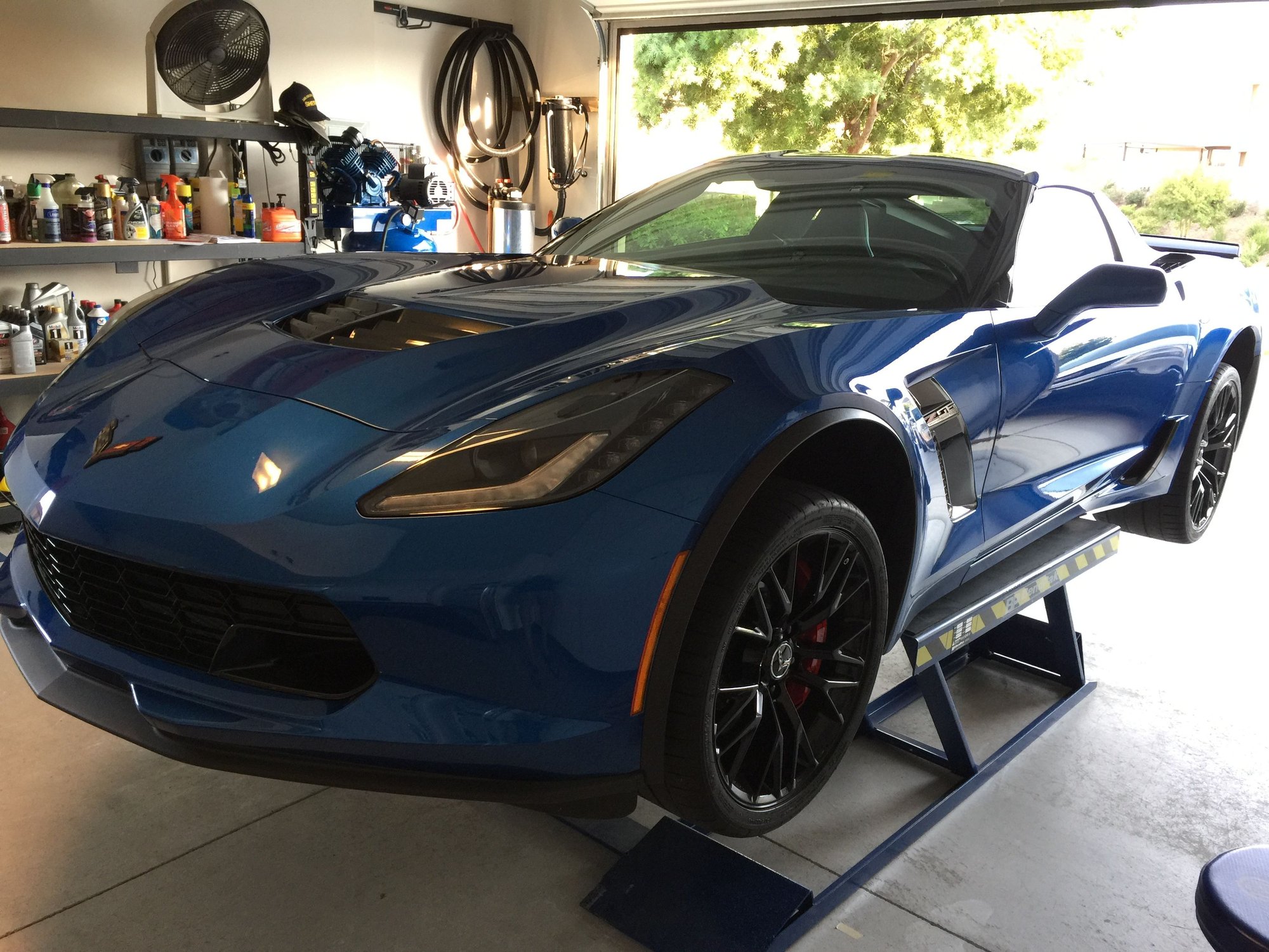

Originally Posted by mammoth713
I dished out the $$ for race ramps and I love them.. I use them anytime I can instead of using a jack. Much safer
I much prefer to put the car up on the race ramps when possible. Just less to worry about.
Brian,
It really depends upon whether you have side-skirts or not. If you do not, I'd recommend the leave-in pucks in post #136. That's what I use, no skirts on my car, and the pucks will always be on the car for any unexpected situation.
If you have GS/Z06 style skirts, you'd probably be better off going with what Kevin is using, which are taller to clear the skirts but they are not leave-ins.
