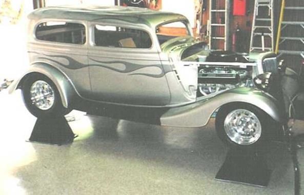

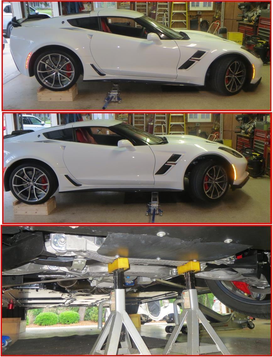

Yep, if you have room and money for a lift great and you can take a wheel off as you state. Same as I did when my Street Rod up on 4 stanchions during construction! Using stanchions is a far less expensive way to feel very safe when changing oil, installing a CAT back system, headers etc!
This Thread might be preventing some from considering doing their own oil changes! It's good if it is causing concern for jacking properly but there are alternative very safe solutions before getting under the car for the very cautious.
Been jacking cars and changing oil (and many other things) for over 60 years. Have had a few issues "when jacking" including a minor one with a C7 but NEVER when I was under the car or with a wheel off as I make sure it's safe first!
Here are a few pics of alternatives. If you're not confident that you can make very strong stanchions, they are available for sale by Race Ramps and others. Frankly I find jacking the car is easier for me than using ramps! Don't have to ask the wife to come out and see if one is sliding forward as I try to go up etc. "Been There Done That," then gave the ramps away to someone who needed to lift their car on grass! I can also get the car level with just a little more effort.
My Street Rod was up on 4 stanchions for many months as I installed exhaust, wiring, trans cooler, brake and fuel lines, seat supports, etc, etc. Still have them but these 12 inch stanchions are higher than I need for the Vette and require a two step jacking procedure.
Race Ramps sells these 8 inch high stanchions and also have a two part stackable product that raises 5 and 10 inches.
I made the wood stanchions from a 2X6 and some plywood for under $10. (There have been posts by others who made them from stacked 2X4's screwed together etc.) Calculated the safety factor of mine for fun and it is well over 15! You could make 4 if desired for an oil change. I am confident the sturdy jack stands I use, properly placed, are safe. I would not get under a car with jack stands holding both ends of the car, but that is my opinion, know some do.

When i use 4 jackstands, i always incorporate the jack itself as well but i do not use the ratchet type i use a good well built passthru pin type.

I have three sets of Jack Stands. An early one is a pin and pipe with holes but have those stored as I like the ratchet ability to set in small increments. Agreed it is one more thing that can break! The ones shown in the pic I use for my oil changes also start at a low level so I can match the 6 inch rear stanchion height.
