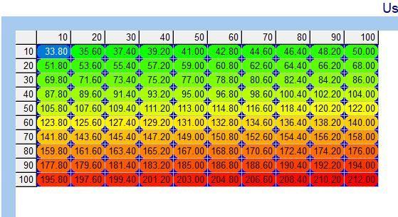

Originally Posted by bjones7131
Anyone know what temp the fan comes on and is it high and low speed depending on temp.? On my previous C5 there were two speeds and depending on temp it would come on and if needed it would go to high speed. There was a cool it mod I bought and installed in 5 minutes that allowed you to bring the fan on via a FOB anytime you wanted. I wish one was available for the C7 but haven't heard or read of anyone having one.
I looked up my fan data from my stock tune for my C7 and shows this table. It is in F°
Elmer
Elmer
Sorry but I need clarification on this. I assume the green, yellow, and red is temps but what is the 10-100 across top and left. Thanks
% of power run by the fan. The hotter it gets, the more power to the fan and the fan runs faster.
Here's the full screen in C°
