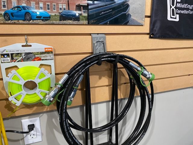

Can't wait to see how you handle your first hydraulic fitting leak. Thankfully this thread has inspired me to get around to installing my new aftermarket fittings today
My Quick Jack came with these? And it also came with the bigger pump?
Purchased mine (5000EXT) from Costco.com, delivered via UPS (aka - Unbelievably Poor Shipping).

These fittings were from Summit Hydraulics. Found the info in this thread.
https://www.corvetteforum.com/forums...pler-fail.html
I bought them off Amazon:
1 pair of female only
2 pair of male and female
I couldn't find any replacement for the fittings that screw into the pump but quickjack sent me a new pair of those even though i was already out of warranty for a bit

You won't need them if you make sure there's no pressure on the system when you try to connect or disconnect. If not you'll ruin the fittings trying to connect them. If the fitting is hard to connect then press the down button to let the pressure off and you won't have any problem. I almost ruined one of mine trying to connect it when it had pressure on it. Not sure why it happens but it does. Also make sure you have the hose clear when you lift the car. If you manage to pinch the hose under the lift when you raise the car then you won't be able to lower it. I had that happen and it was a pain to get the hose out without damaging it or dropping the car. Just remember to be careful and pay attention. It's a great product.

I would hold the down button for prob 30 seconds after the car was down and that didnt solve my problems. I never had an issue connecting of disconnecting so pressure wasnt an issue in my case at least. I completely understand what you're saying about maintaining pressure in the lines though and while that may be the case for some with leaky fittings I do not think that covers all cases of leaky fittings. QuickJack is pretty good about sending new fittings out if you email them saying the leak so i think they know it's a problem sometimes. In my case i believe only 1 hose fitting and 1 fitting on the pump leaked. It was never a dangerous level of leaking but i didnt like having to put paper towels under my pump each time i used it so i just went with all new fittings. Holding the summit fitting next to the QJ fittings I'll say the summit fittings do feel better quality and i believe are a bit bigger.
i think most QJ's end up leak free thankfully but there's plenty of cases of mild leaks just on this forum alone. Still a great product imo i use mine all the time
