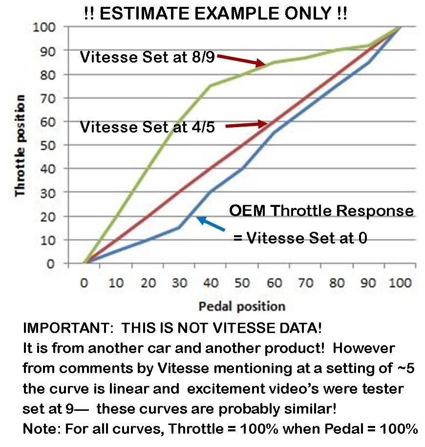

I have a 19 Stingray M7 non-Z51 that I want to upgrade the stock throttle body. Heard really good things about Soler. I see I have a choice between 87mm and 95mm in diameter. Will I notice a significance difference between the two sizes? Will I even notice a significant difference with Soler compared to stock? Anyone have any insight on this? Appreciate any comments. Thanks!
As noted for the LT1, one size! It's a modified OEM throttle body. Easy install, works great.
My Experience:
Had a 2014 Z51 Without MRC and drove mostly in Track for the other benefits, including faster Throttle Response. Got a 2017 Grand Sport that comes with MRC. Had to drive in Touring to get a ride like my Z51 none MRC! In Sport it was initially harsh hitting even small bumps. Was frustrated with the slower Touring Throttle Response (called slow Tip-In) especially when taking off.. To get what I had with my 2014 would have to drive in Track! That rattles your teeth even on the relatively good, pothole free roads in Eastern SC!
Bought a Vitesse throttle controller and set it mid way at 4/5 setting out of 9. That about matched what I had in my 2014. Got the GM MRC software upgrade and was able to drive in Sport with the features it provides including faster Throttle Response. No need for the Vitesse which only provides more throttle movement for a given throttle movement. Saw comments about the benefits of modified Throttle Bodies. The Soler tech info showed why it was different and better than just increasing throttle movement for a given pedal movement. (note they now sell BOTH but I just installed their modified throttle body and saw a significant improvement when "taking off" with my M7 and with a quick pedal movement when accelerating while moving!
Since my business involves gas flow transient movement, understood what they accomplished. Validated with info from other modified throttle body sellers info.
Made a PDF of my "Install and Why it Works" (which if you're technical may be of interest: http://netwelding.com/Soler_Mod_TB.pdf
GREAT PRODUCT!

Think it's more than just driving for an hour. Takes starts and stops for the air/fuel MAP to adjust.
Also may depend on what you are expecting! I had a Vitesse throttle controller but only set it at 4 versus the 9 level where some say "what a big difference." Not sure of the Soler throttle controller range but this pic may help. It is from another throttle controller company BUT the C7 OEM "tip-in" appears similar. Note the OEM throttle response, like many cars only opens the throttle body ~15% for ~30% peal movement. That is a typical "slow tip-in." Makes it easier for the average driver in bumper to bumper traffic, for example, to control the car. With the throttle controller set at max you get ~80% throttle body opening at ~50% pedal movement. NOTE all are 100% Throttle Body at 100% pedal. You get zero extra power just the perception of more! I call those settings, "Boy Racer!"
After I removed the Vitesse Controller, once I was able to drive my Grand Sport in Sport Mode 95% of the time (where the throttle response is faster,) I still felt the small lag with the OEM tip-in. It was particularly noticeable when taking off from a stop. The Soler definitely reduced that slight "hesitation." I also can tell the difference with significant pedal movement when cruising but that is more subtle. If you want to feel the "Boy Racer" difference you'll need their controller!
SIDEBAR
The significant change some experience (and like) with max response setting on a throttle controller reminds me of my first car! As a teenage I modified a '41 Ford Coupe by replacing the flathead V8 with an 1/8 bored '50 Olds engine. The OHV Olds was much higher in the engine compartment. The car used a pivot level arrangement from the gas pedal to where the vertical rod from the pivot attached to the horizontal linkage to the flathead carbs. To clear the Olds engine, the vertical rod had to extend above the pivot point by about 5 or 6 inches. Cut the upper rod and had an extension section brazed between. That worked BUT with about a 1 1/2 inch gas pedal movement I went from idle to the 4 barrel fully open. The gas pedal was still over and inch from the floor at max throttle opening! Bit tricky to modulate but got used to it! BUT 60 years later not what I want now!
