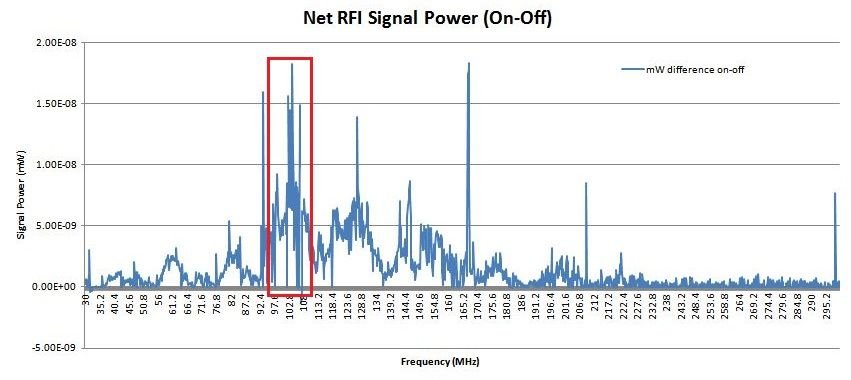

Why aren't you using a ferrite core to suppress the EMI, sounds to me like that is whats causing the issue, I see the idea of a cap but I'll leave that one alone.
All LEDs create some degree of EMI, even if negligible - I work for Boeing and there are certs (DoC) we need for certain types of designs as they can cause interference with comm equipment in the MHz range.
Its probably the LED type used that is causing excessive noise or spikes in noise that are interfering with the TPMS signals. I have the LED sidemarkers on my C6Z but never heard or seen issues of those in the C6, again maybe the LED type used or overall design doesn't have RFI/EMI suppression accounted for. Here is an example of noise generated by LEDs:
The OEM TPMS appear to work at 433mHZ so the following should work (and they are clip on) - There are many other ways to solve this including soldering ferrite beads but I think you guys get the idea

Good idea. If you have the problem and cap fixes it, then it'll be an easy fix that everyone can do to correct the problem.
Elmer

This is a 10pf capacitor. $0.75 each.
It would be connected to the 2 leads going to the light.
Elmer

Why aren't you using a ferrite core to suppress the EMI, sounds to me like that is whats causing the issue . . .
An excellent idea.
My Z06 is in the shop (hit a deer) so I cannot check. Will someone please put a caliper on the group of wires leading to the connector to which the marker is attached?
My guess is a 3.5mm(0.14inch) inner diameter ferrite core choke will do the job, but I do not trust my memory. 3.5mm is the diameter of the average computer mouse cord.
https://www.mouser.com/ProductDetail...tNDzC2jA%3D%3D
Sorry guys I dont have a C7 otherwise I'd be out mucking with it to see what I find out instead of posting
Since I would prefer to not violate the wiring on my car, if the problem shows up, I will put the ferrite chokes on before soldering in the capacitors. It is a bit more money but non invasive. Thanks for the suggestion and I should have thought of it also as I have a couple of those on some control wires on my ham radio station.

Whatever, choke or cap, but if it works and is easier to use the core to wrap around the wires, git 'er done. As long as we have a fix, we're good.
As I said. I have the Oracles and don't have this issue.
