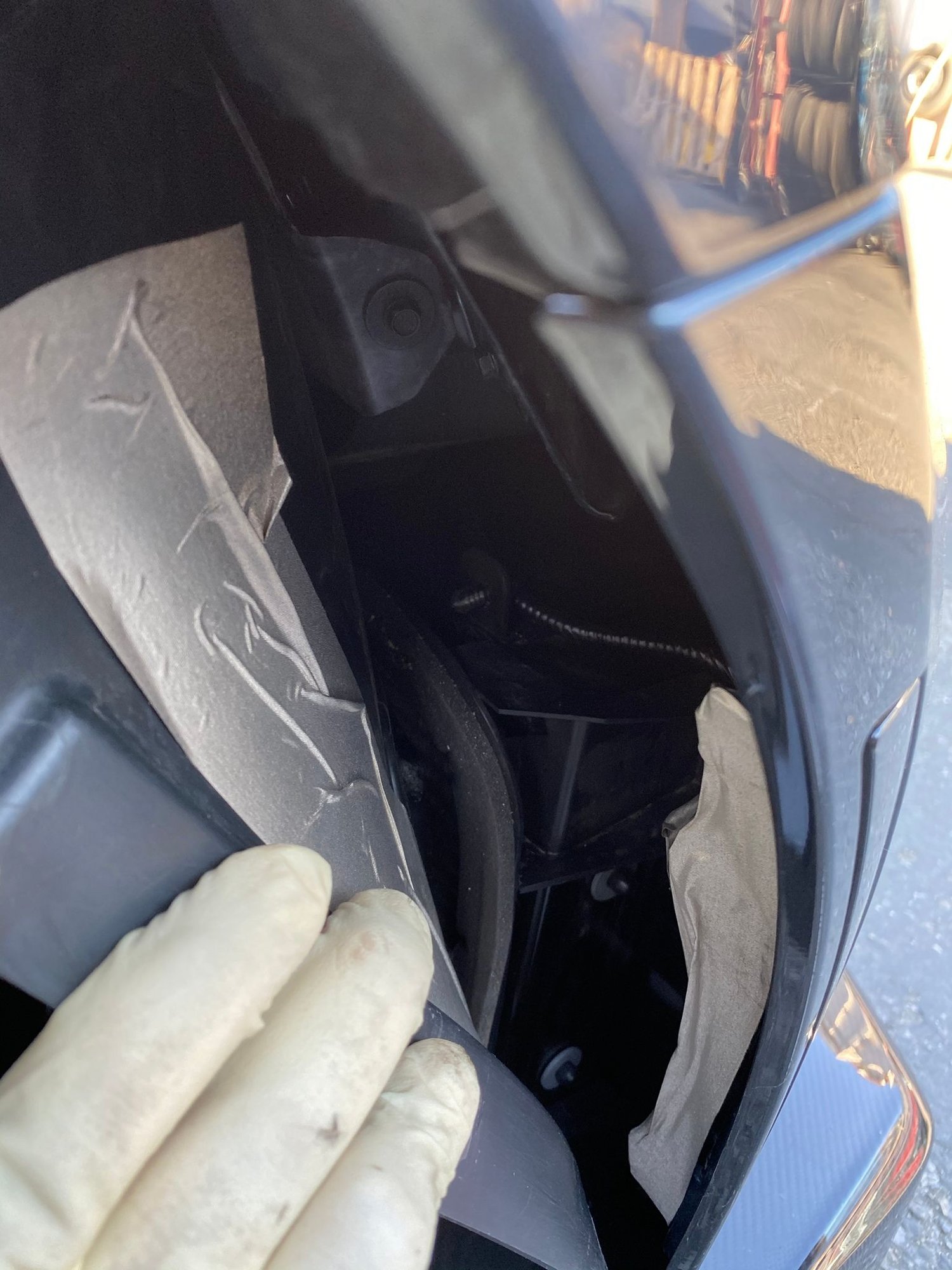

Exactly how it went for me. If I went all freeway speed, I’d lose the RF always around the same time. And sometimes the LF would drop shortly after that, and that was usually right as I’d be getting off the freeway so perhaps if my commute was longer dropping the LF would have been just as consistent. No matter what, the rears always worked. Stop and go city speeds, my fronts were slow to update at times but they never completely dropped.
Not sure if I ever shared this picture in my own thread in the ZR1 section, but here’s what I tried with Farraday tape on the RF light. I encased the whole back housing of the light and put an extra strip inside the fender liner for good measure. This made zero difference. So I’m very surprised the HVAC foil tape made a change for the OP here.
Seeing as how Farraday tape is designed to block RF noise. But if foil tape got the job done, then that’s awesome. Not sure how. But that’s great. If I had more patience for trial and error I would have tried ferrite over the wires.
But after going in there three times (third time was to switch the front lights back to stock), the next time was going to be the last. So when I went to order the Oracles I emailed CCA tellling them the situation, and Chip emailed me back and said he knew all about that. The ones I got from SCP were Chinese sourced and the Oracles will not have that problem. So not to sound like a broken record, but if you haven’t bought lights already and don’t want to potentially go through this hassle, just get the Oracles. Unless you just cannot live with them not sitting perfectly flush or you feel that the slight extra cost for Oracle is not worth it for being brighter and having no TPMS hassle.
