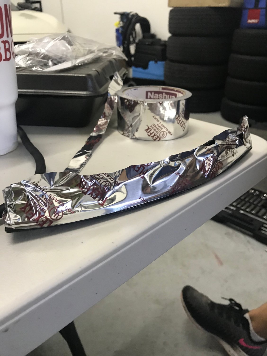

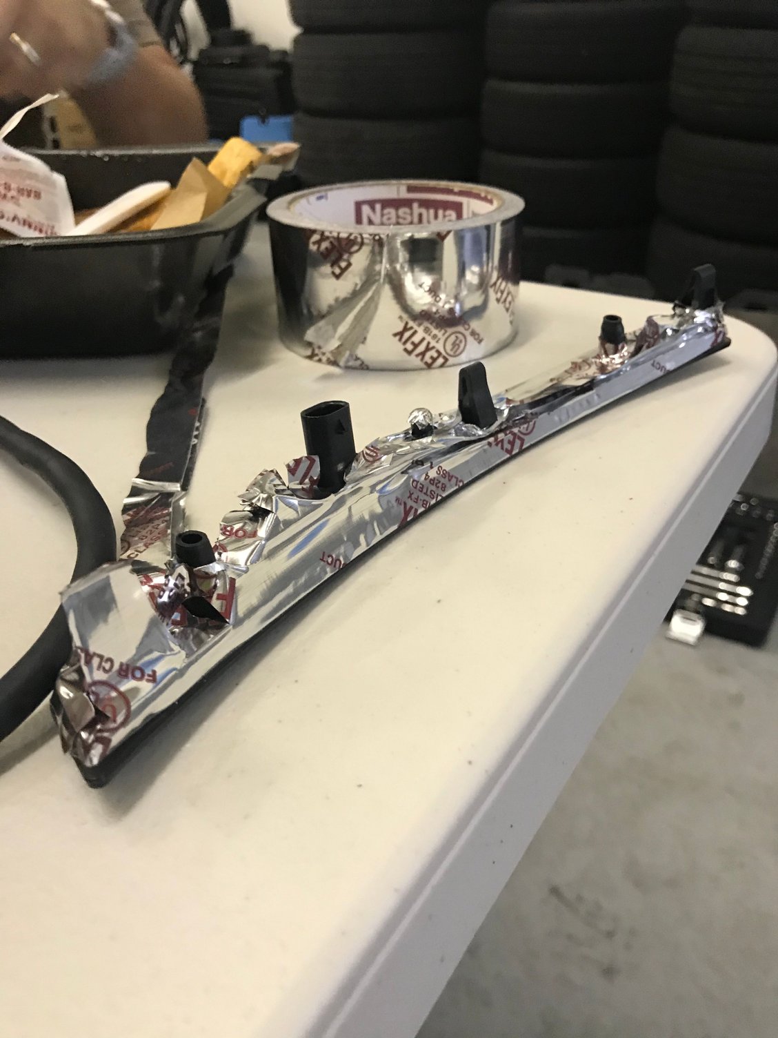

let’s see how this works out!
Looks like something we kids did back in the 50's playing space sputnik games !! Love it !! I hope it fits back in the slot !
Please let us know if it works Thanks
