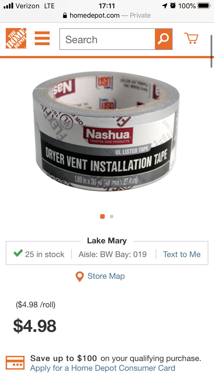

I had a 15 min drive at 75-85 on a toll road, headlights on, no error messages.
I will drive again tomorrow and Sunday and report back.

Did you tape all four?
Old Jun 12, 2020 | 10:48 PM
  #183
2019Vette's Avatar
2019Vette
Joined: Mar 2019
Posts: 673
Likes: 325
From: Orlando, Florida
yep. All 4 got 2 layers of

Do the lights pop in the same with no problems with the tape? Especially with 2 layers? Thanks

This morning I opened up the front lamps and installed the chokes on them. The exposed wires were long enough that I could fit the smallest chokes on them. The only one that I used a larger choke on was drivers rear as I chose to not remove part of the wire loom to allow the length to be enough to fit a small one. Your cars wiring looms may be slightly different.
BTW, you place the chokes over both wires and clip them shut.
Best of luck to everyone that has been having issues with this and hope it is a good fix for you also.

Thanks for the testing and follow up. A cheap and easy fix.

it was the first time I put these lights in, they fit perfect yep.

So how do you know if your side marker lights even affected the TPMS if this was the first time you put them in with tape already installed?

I don’t - but the probability of it happening was very high as I understands it’s the JW LED lights on 2019 and some others randomly.
and since I had a lot of work done on my car and the wheels were off I made it a 1 time event to mess around with them. I don’t have any space as my cars so low to get in there and change them so, figured it’d attempt to stop it if it was ever going to happen...
