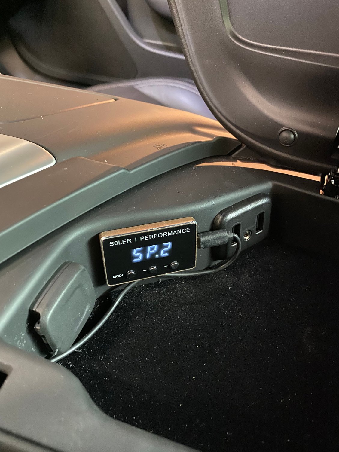

Great looking install. I should receive my TC later in the week. How did you run the wire to that location?

This is how I did it .....
Remove the Console Lid (3 Screws)
Remove side trim, starting at the back and working your way towards the Front. Be careful at the front area, if you pull it out you can break the Tab. you have to pull toward the back of the Car.
Slightly ease up the Center console, I used a 1/8" Round File to create a small half round notch for the Wire. Fish the Wire through and it is done.
When the Lid is closed you do not see the Wire and there are no pinch points.
Probably sounds more complicated than it really is.
I had a harder time connecting the Unit to the Accelerator Pedal due to space restrictions.
All said and done, I love the combo, the Car feels alive. Current Setting is at SP.1

Thank you for this. Makes me a little nervous pulling the side trim off. Did you use any specific tool for this?

You are welcome.I used a Plastic Trim removal Tool.
There is a YouTube Video showing the dashboard removal on a C7 , perhaps look at that first.
I was a bit nervous too but take your time and handle it carefully, don't force anything .

My Throttle Controller came in today. Just completed the install and I installed mine like you did. That’s a nice, clean way to do it. Thanks for the instructions. It really was a piece of cake.

Very clean. Where did you get the custom mount plate in the center console?

" The Plate" is actually the same piece of Foam that the Unit is shipped in. I just cut is as close to the profile of the Center Console and wrapped it in Black Fabric. No need for Two Way Tape and it stays in place.

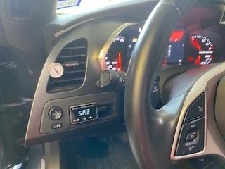

Talk about “Bang for the buck”. I couldn’t be any happier with this.
I bought a TB and the controller at the same time. After waiting for two weeks for them to arrive (sat at the Mobile Postal Distribution Center for 10 days) and for two weeks on me to get around to installing, they are both in. I installed the TB first and could see some drivability improvements right away.
Next came the controller. Took me longer than expected due to poor mobility/flexibility and pain, due to still recovering from a surgery that went horribly wrong in July. Mike suggest SP5 for a setting and I believe it is spot on.
Like I said, I was a little challenged being down in the floorboard, so I didn’t get fancy with the location, but I actually like where it ended up.

I located my controller above and centered to the HUD controller. I can see it and adjust as I want. Now back to the controller. It is incredible, makes driving so much more fun. Don't know what you are missing!
