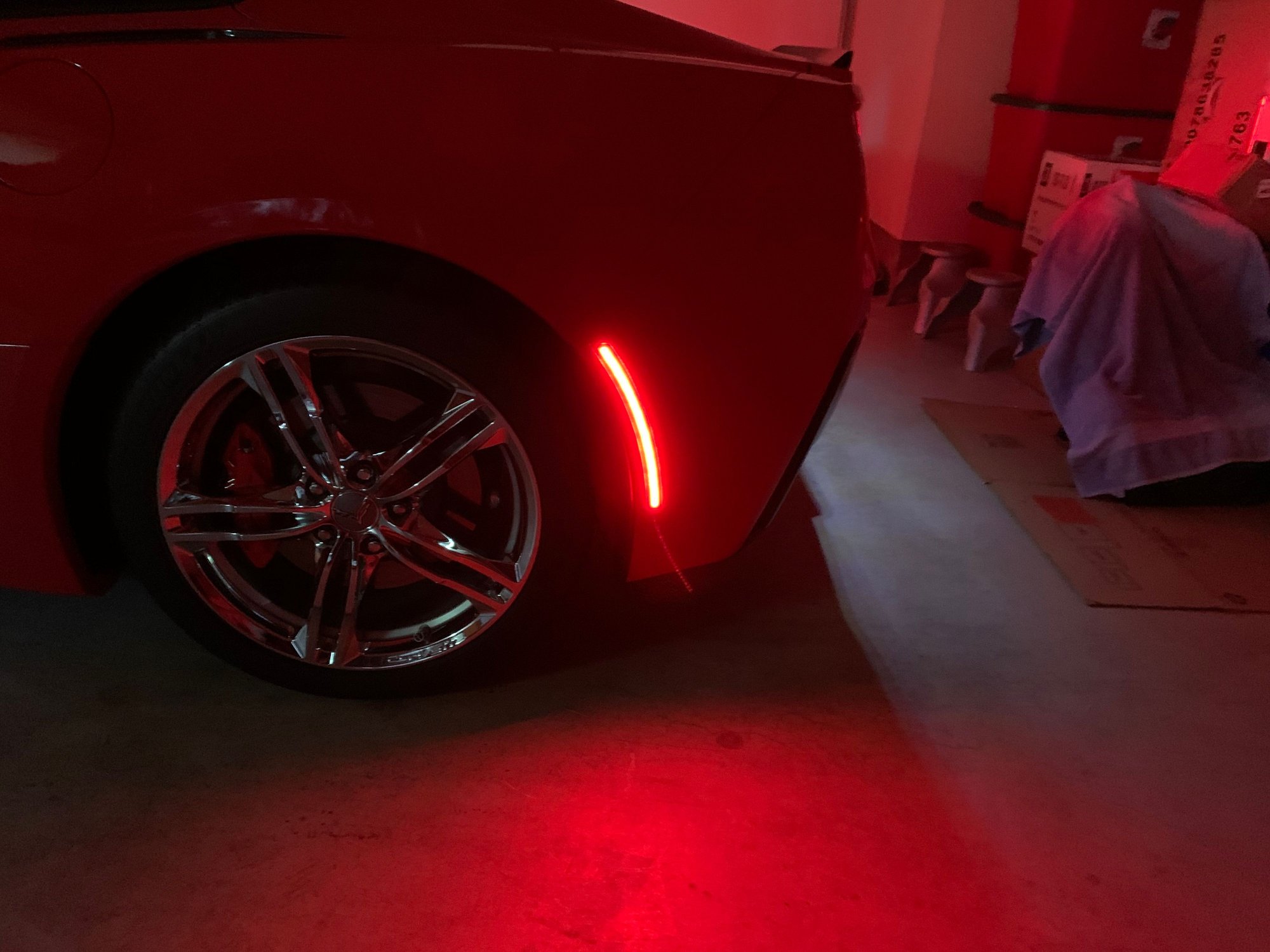

I installed the ones from JWM several months ago. Easy installation. Plug and play. I have only had the TPMS problem one time on a long drive at night. I will probably look into the ferrite collar fix this winter. I really like the smoked LED look. Here's a pic of one of my side markers on my 2016 Shark Gray Stingray.
