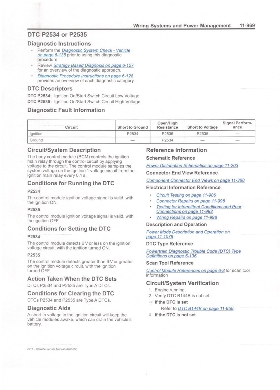

Battery is said to be 1 and 1/2 years old. P2534 code is correct.
Old Jul 6, 2021 | 03:20 PM
  #50
ErnieN85's Avatar
ErnieN85
Joined: Feb 2002
Posts: 3,726
Likes: 368
From: Montoursville Pa
My Bad I transposed numbers
P2534 CHEVROLET Possible Causes What does this mean? Faulty Ignition Switch Ignition Switch harness is open or shorted Ignition Switch circuit poor electrical connection
Read more: https://www.autocodes.com/p2534_chevrolet.html
on our cars this is controlled by the ECM

good info, what is the location of the Body Control Module ?
Old Jul 7, 2021 | 07:52 AM
  #52
ErnieN85's Avatar
ErnieN85
Joined: Feb 2002
Posts: 3,726
Likes: 368
it is under the passenger toe board, might be just a loose plug or broken pin in the OPS case
