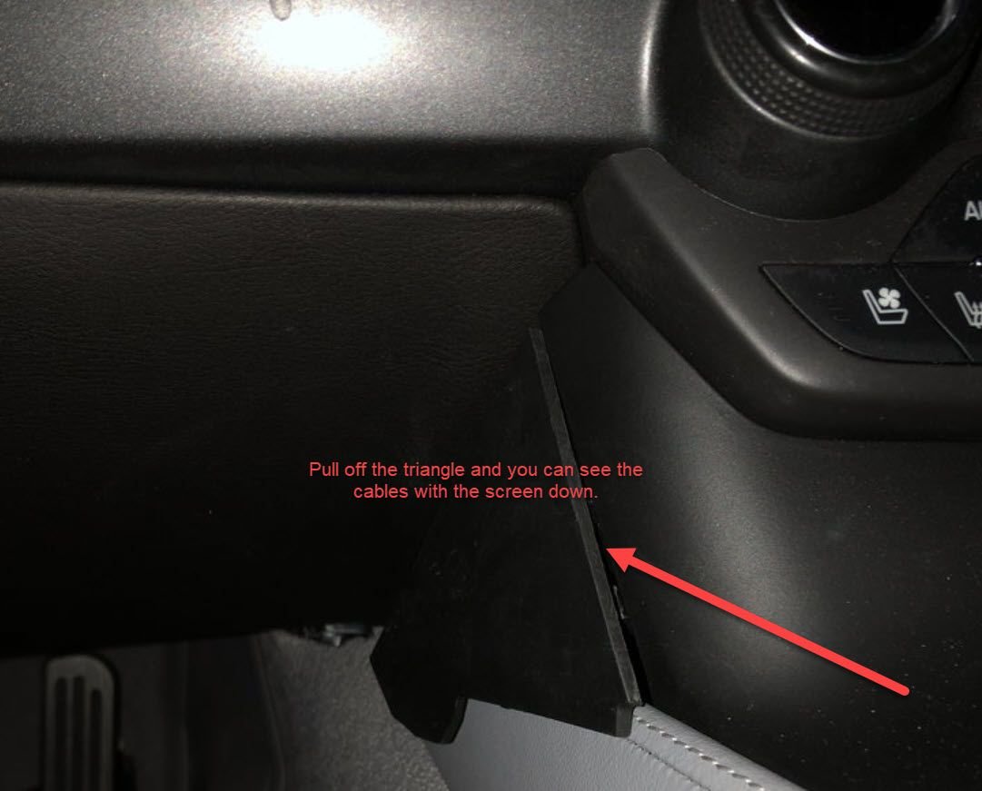

Sometimes honking the horn will bring the screen back to life, but only for a short time. That just helps confirm it could be something other than the screen itself. My 2014 had a flickering screen at first and then decided to go black. I decided to tear the dash down so I could get to the cabling the proper way and found them to be shredded and loose from the door being used too many times. I bought a
new cable new cable
from Amazon for $6, and the problem has not come back since. It took a long time, but I only pay myself $1.50/hr, so it was much cheaper than the dealership. You can't really check the cables very well from the little access port in the footwell. You can see them, but not whether they are loose or frayed. In the picture below, the triangle cover isn't attached correctly.
