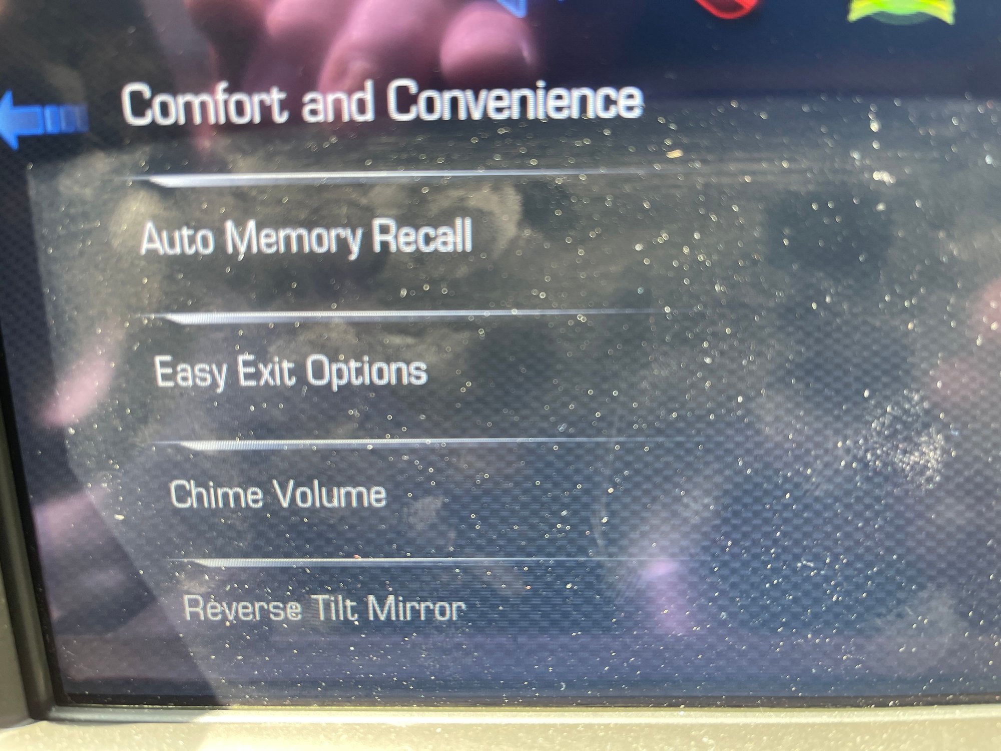

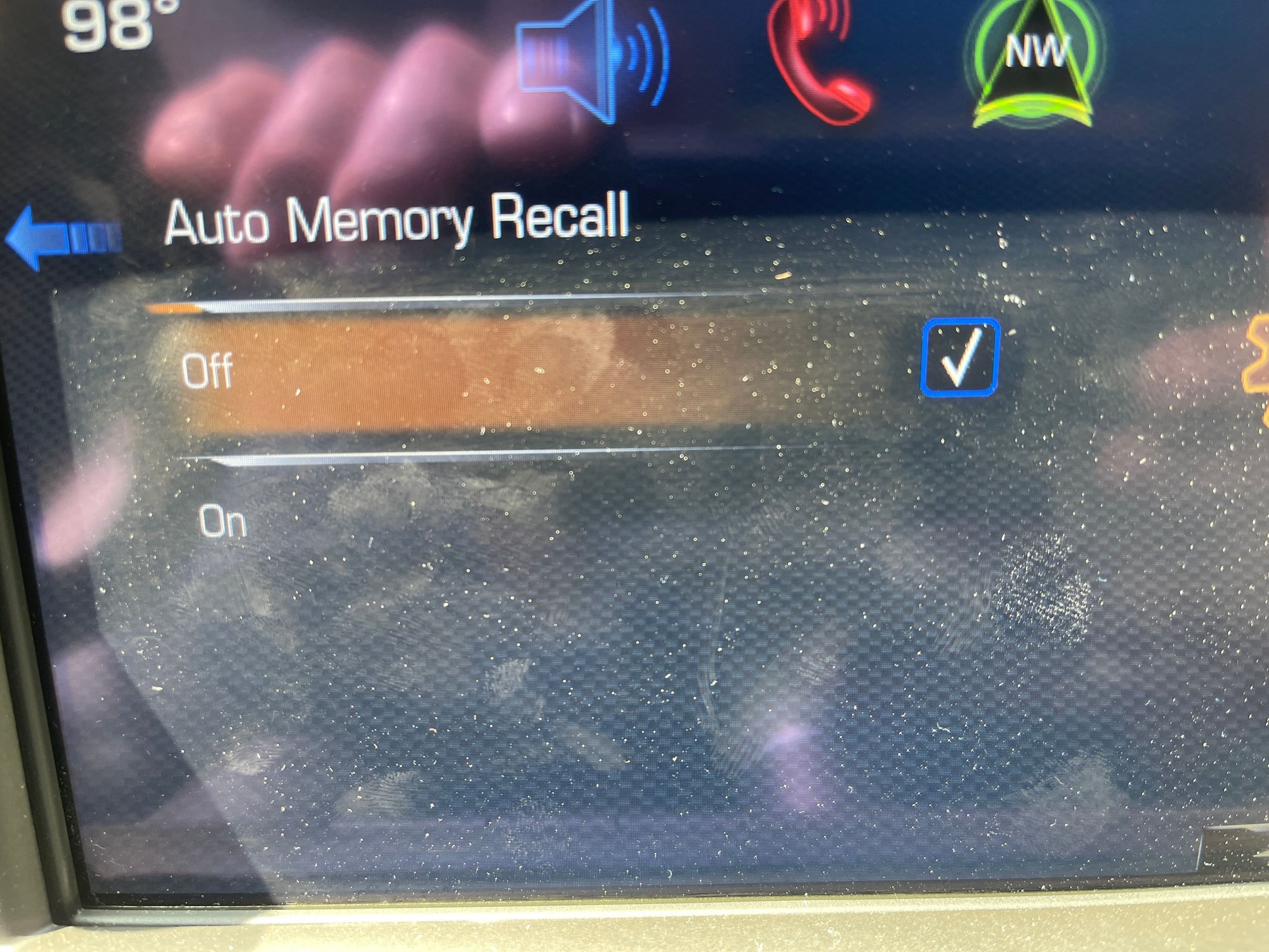

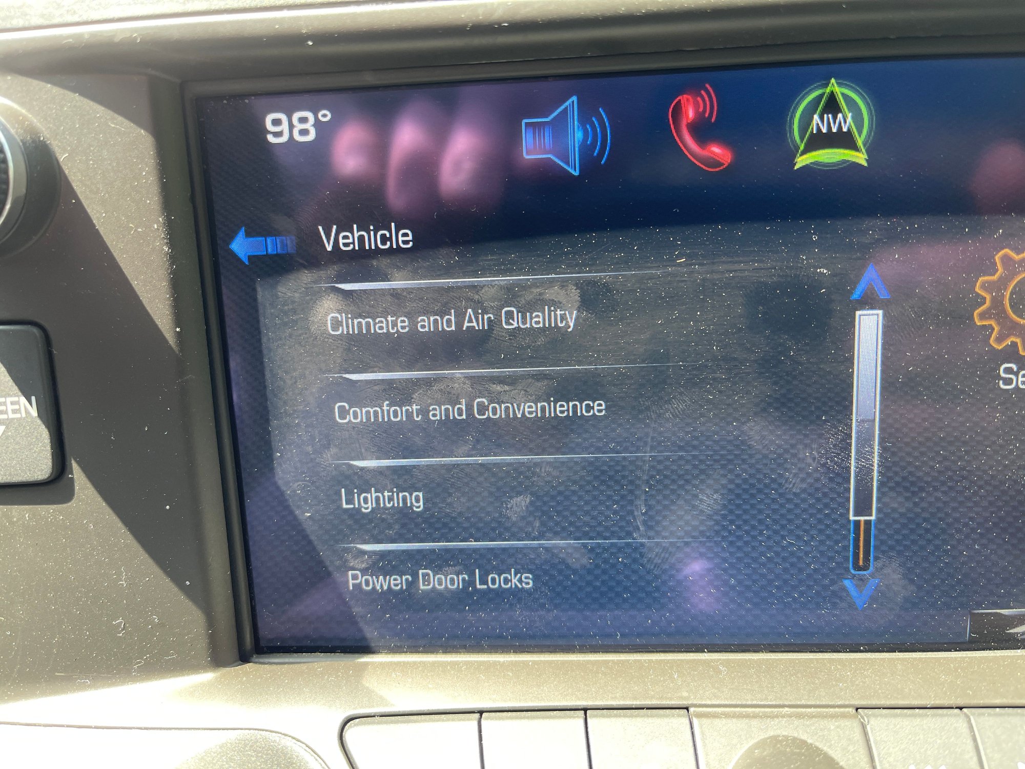

I just looked through settings and I think it might be a software revision thing because I don't have that capability here's three photo's showing going into Comfort and Convenience, then Auto memory recall, then inside Auto Memory Recall which only has an on and off

You might be right, Look at post #14 in below thread.
https://www.corvetteforum.com/forums...t-working.html
Old Jun 5, 2025 | 05:44 PM
RonC7's Avatar
RonC7
Joined: Dec 2012
Posts: 3,858
Likes: 1,863
From: St. Louis Metro East IL
If you have a 2014 M7 the post noted above is your answer. Probably cost you an hour's labor at the dealer.
Or see post #4 in this thread. Same answer, just before and after pics:
2014 M7 seat memory update
Ron

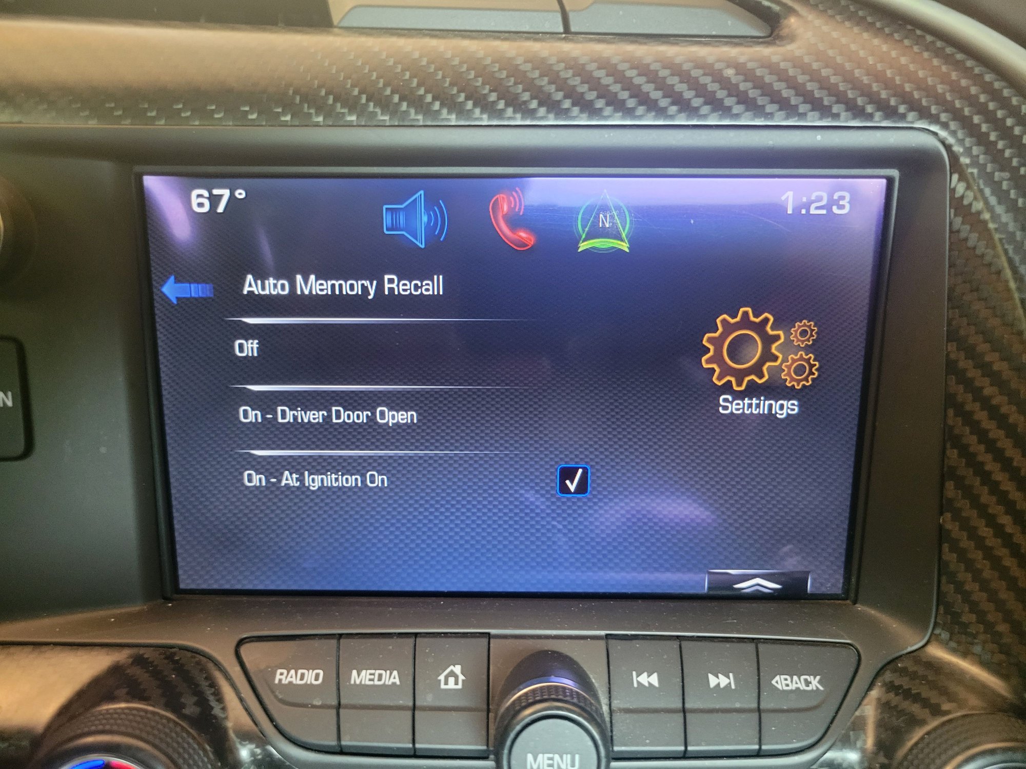

Had TSB done to my 2014 M7 in March 2024.
Dealer charged $135. Worth every penny.

I finally got a pic of this in my car. This is what it should look like with the software update.
To seat memory question
