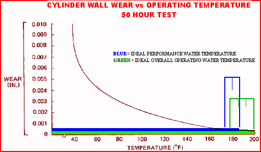

Here is an interesting article about the 160° thermostat. Source: http://www.carnut.com/ramblin/cool3.html
A few of you good folks must have spotted other articles that I have done either in print or online about this subject. At the request of a few folks here I am putting this up for what it's worth and expanding some information about this as well. The argument is about running 160 degree thermostats and the good and/or bad results. Now keep in mind that thermostats have absolutely NO effect on your systems ability to cool, simply a regulator of the range it operates in. So, if you think a 160 will cure an engine running at 220 with a 180 thermostat...forgetaboutit! This is not about cooling capacity at all.
The graph to follow illustrates the importance of how critical optimum coolant temperature is to the longevity and performance your engine. Cooler water makes horsepower and warmer water minimizes engine cylinder and bearing wear...or so it's thought, but only to their own limits and ranges. There is a range where both optimum performance as well as minimal wear share similar characteristics. That number lies in the 175-180 degree range as shown by the overlap in the chart which correspondingly requires a 180 degree thermostat. FWIW, higher operating temperatures of today's engines are to fight combustion by-products and pollution. Also, engine oils are designed to work over a specific temperature range with optimum performance starting at temperatures that require the coolant to be the very same 175ish range. And don't forget the moisture issue. Have you ever seen water vapor coming from your tailpipes? Sure..and the very same thing happens INSIDE your engine. Your engine forms moisture inside when it cools and condensates on the walls of the inside. This moisture the is washed down into the oil when started and then awaits vaporization by internal temperatures rising enough to bring the moisture to the appropriate corrected vapor point (boiling). If enough moisture is left behind it combines with combustion byproducts to form acids that become dissolved in the oil itself. The oil becomes more acidic as the age of the oil progresses and picks on certain parts eventually. Also moisture will corrode other surfaces. So, it's important to get these engines to a satisfying operating temperature as soon as possible. Usually oil pooling temps are about 30 to 40 degrees higher than the coolant temps. This is a generalized statement and can vary with load and engine design but you can see why you want your oil over 212 degrees to boil out the moisture immediately! A 160 thermostat usually does NOT accomplish this temperature.
Years of research show use of 160 degree thermostats is way too low to be considered for performance or engine longevity. As the chart above illustrates, engine wear increased by DOUBLE at 160, than at 185 degrees. The 160's were invented for and commonly used in older, open loop cooling systems where only 6 pound radiator caps were used, and low 212 degree boiling points were the limit. We know better now.
Many early hot rodders found the 160's to be a smiggin better performing than the 190's, however the in between 180 appears to satisfy both ends of the spectrum. The correct water temperature and thus resulting metal operating temperatures required for the cylinders to achieve a minimum specific temperature in order to allow a fully mixed Air/Fuel charge to combust efficiently is a minimum of 180 degrees coincidentally. If you use 160s be aware that this can have a degrading effect over a time on your engine. I know alot of rodders still using them however to whatever ends they want...and that's okay. Heck, I know guys that run NO thermostat and most of you know that's another book to be covered. I just report what I learn...and you decide what's best for you. I hope this satisfies you information junkies out there.
Steve Jack

terrible information. I guess steve jack has never heard of evaporation. you don't need to boil water at 212 to get it to rise as a vapor. what a moron.
and yes, you can easily achieve much hotter oil temps than coolant temps. like I said, you want hot oil and cold coolant. don't you think the oil cooling system will also have a direct affect on the oil temp? did you know the oil coolers also can restrict flow through the coolers until a preset temp? you can always get the oil hot....low coolant temps don't mean low oil temps if you do it right. Steve jack just wasted his time making a chart...guess you bought in.
Russ, you just said you cruised at 175-180 with a 160 thermostat and a stock radiator. then you post some guy (with no link) saying you need a 180 to cruise at 180.....you and I both know that is wrong. your car will always run hotter than the thermostat rating. even you experienced this.
think for yourself. dont rely on some internet unknown think for you. the answer is right in front of you, why search for anything else? you are wasting your time.
build to a goal and under a specific use. your old car was not set up to be raced as coolant temps would rise. all you had was a thermostat. you did step one.....what about the rest?

Well, as you could imagine, I don't agree because I consider all facets of the modification you are endorsing.
It would be good information for you to outline the cost and estimated benefit in terms of power if we changed to a 160° 'stat.
From what you have hinted, there will be cost of a new radiator, tune and installation labor. I am assuming its a stock car otherwise. What additional power/torque have you experienced?
Appreciate your input.
