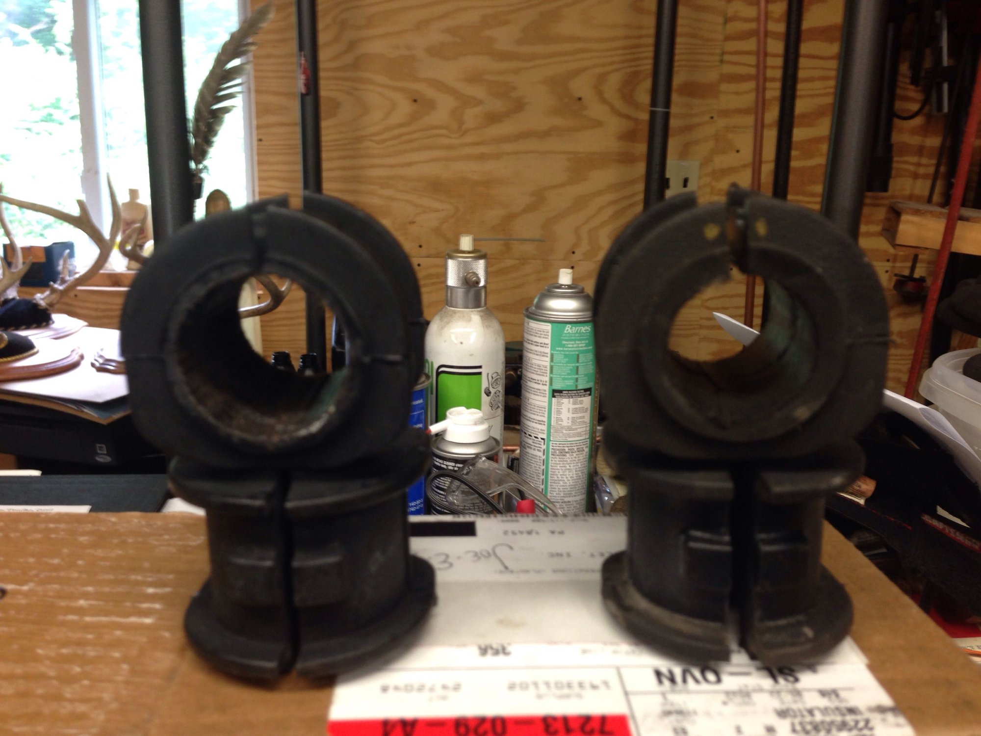

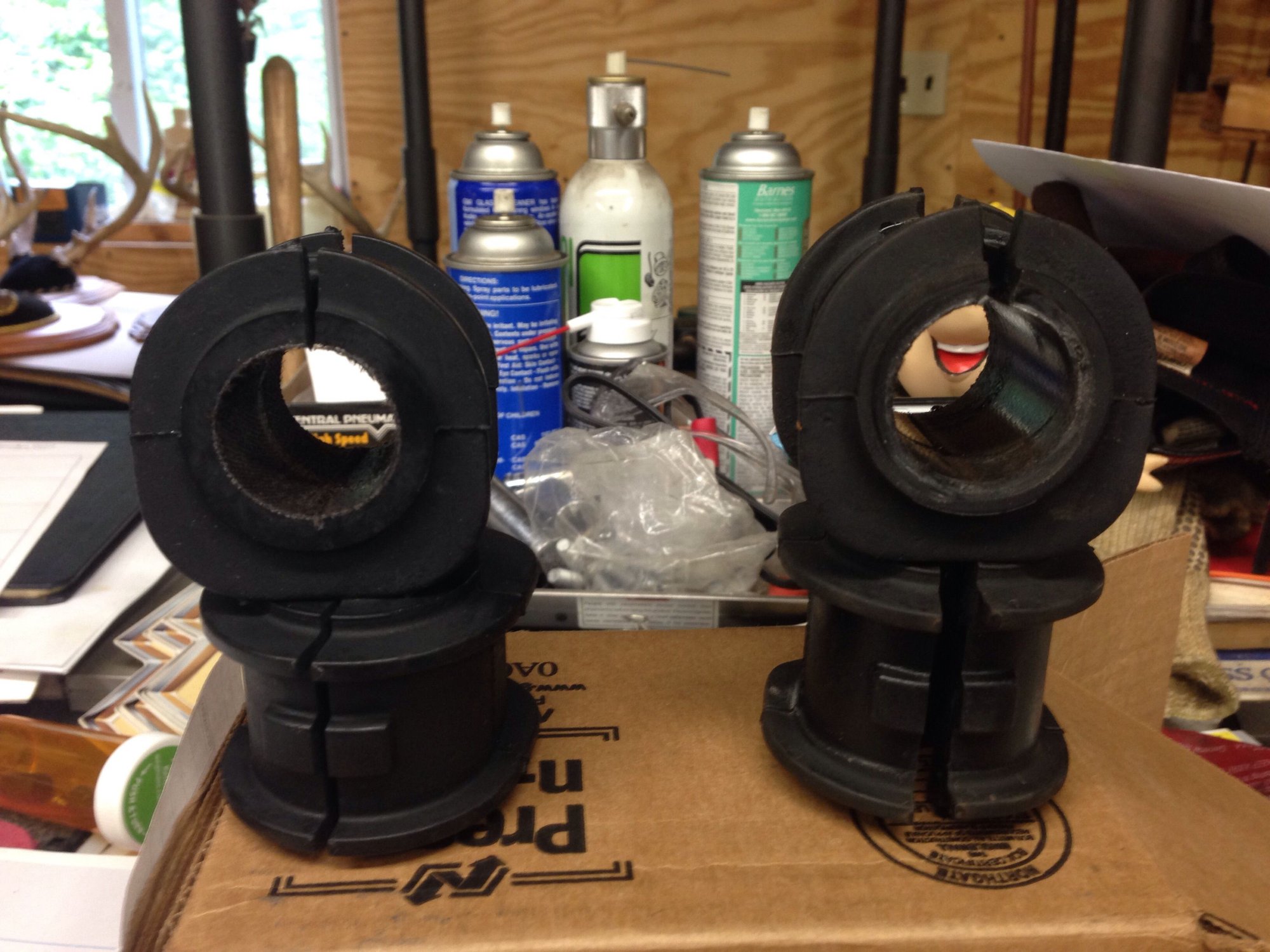

Added the mag-ride rear sway
bar ( much thicker than z51 non mag-bar) and the zo7 bushing front and back, I can without a doubt feel a stiffer car, I have a event next weekend and will post if car has less sway or not, it was worth the $160.00 for the test( don't know why Gene Cully has not put a kit together yet) as I said the real test is with A7 Hoosiers on.

New zo7 bushing on left side, much stiffer than z51 non mag bushing

here are the part numbers for the zo7 bushing, fronts on top.
Thx for the info--I ordered the front bar insulators today--cheap!

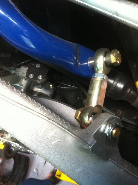

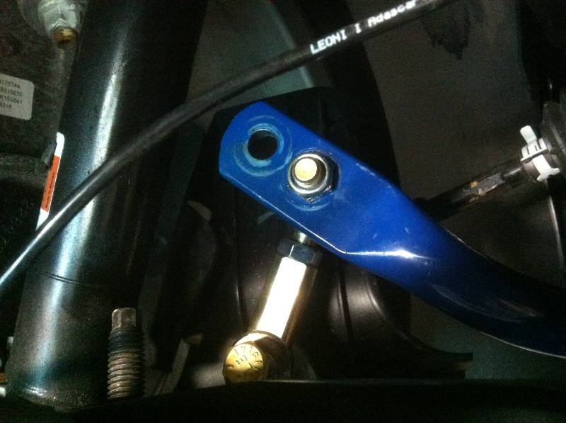

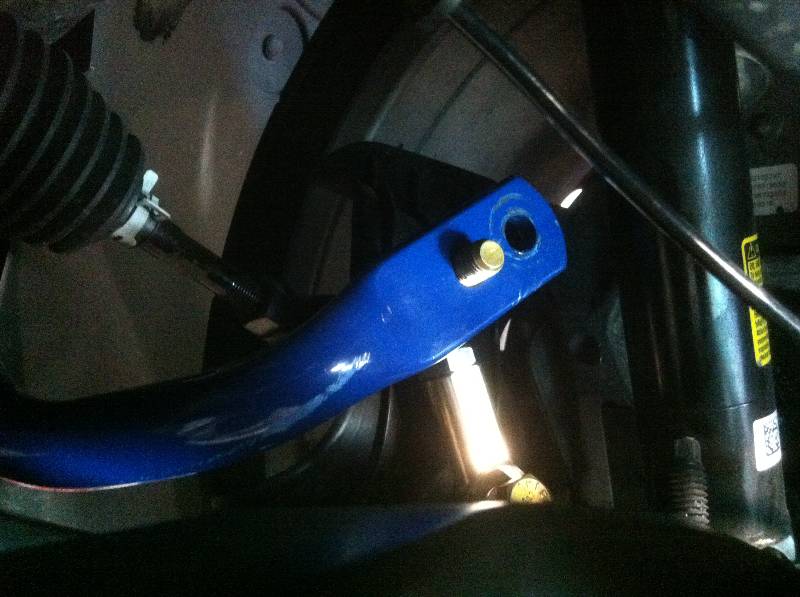

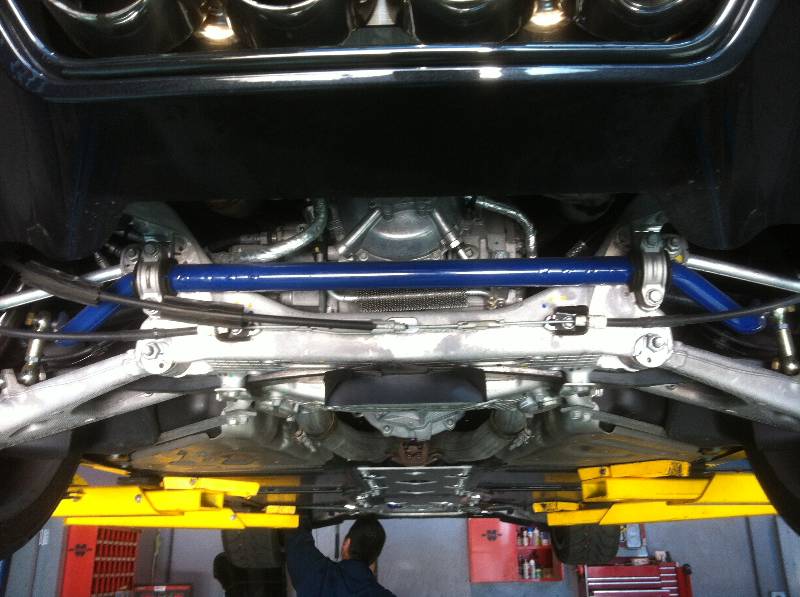

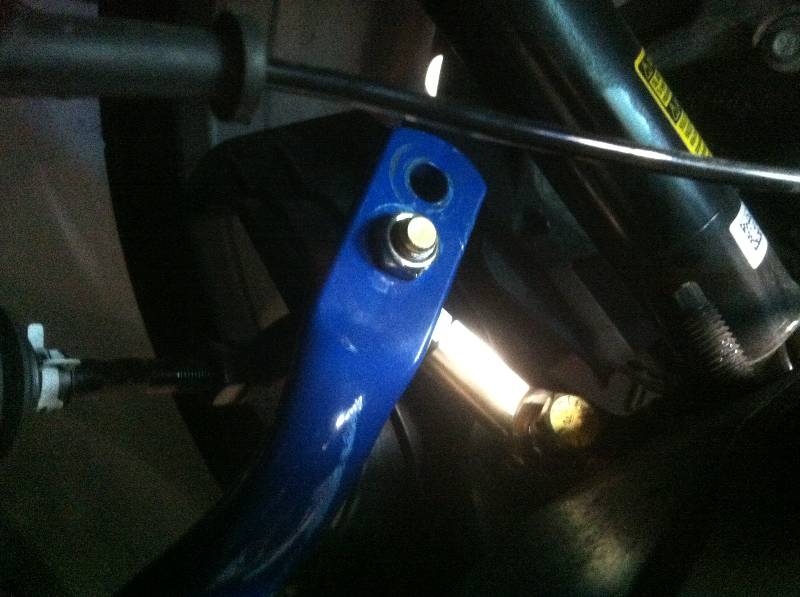

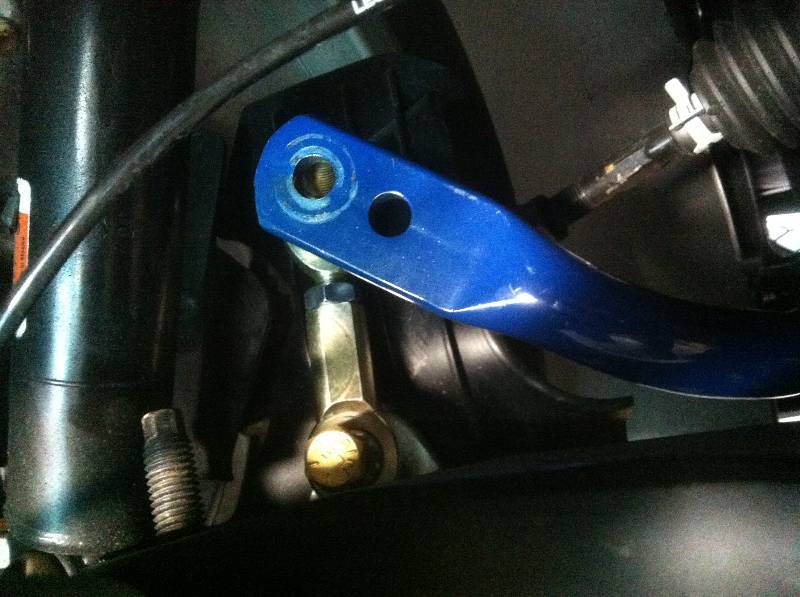

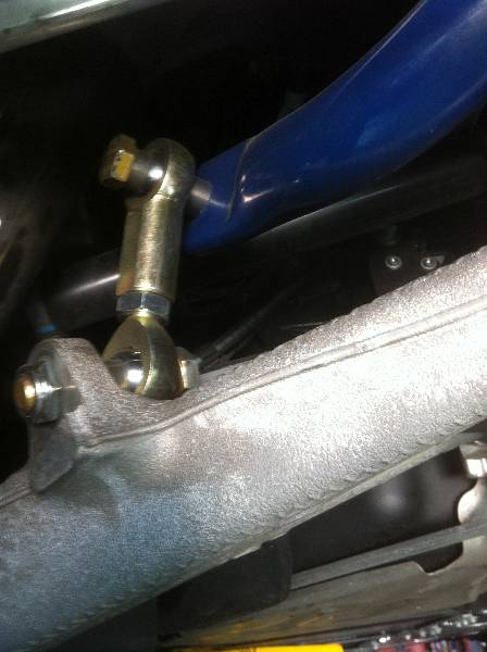

So I didn't get any pictures of the LG bars when I installed them (sorry).
But I changed the connection hole in the front this morning (from not firm, to firm),
so I took some photos of the bars.
Here is the rear left link
Here is the rear right link
Here is the whole thing
Now, for the front, I could only get shots of the link ends... just can't see the whole bar.
Here is the front left link with the bolt removed from the not firm hole
Here is the front right link with the bolt removed from the not firm hole, and placed in the firm hole
Here is the front right link with the bolt in the firm hole tightened
Here is the front left link with the bolt in the firm hole tightened
We'll be autocrossing tomorrow, to see how much difference the change (in the front) from
not stiff to stiff makes.

Nice pics, NTMD8R - too bad LG can't be bothered to provide details like this on their own website ...
Anyway, really hope you're happy with the stiff setting on those bars for your autocross tomorrow.
Good luck, enjoy and POST RESULTS !!!

Results from changing front bar to "stiff" setting.
Hmmmm..... not really sure, but I think I had too much front bar.
The back end would really break loose more easily around arcs and corners
(more judicious application of the "go pedal" was necessary.... more than I am used to).
My wife has asked me to set it back to "not firm".
I'll do that this week.

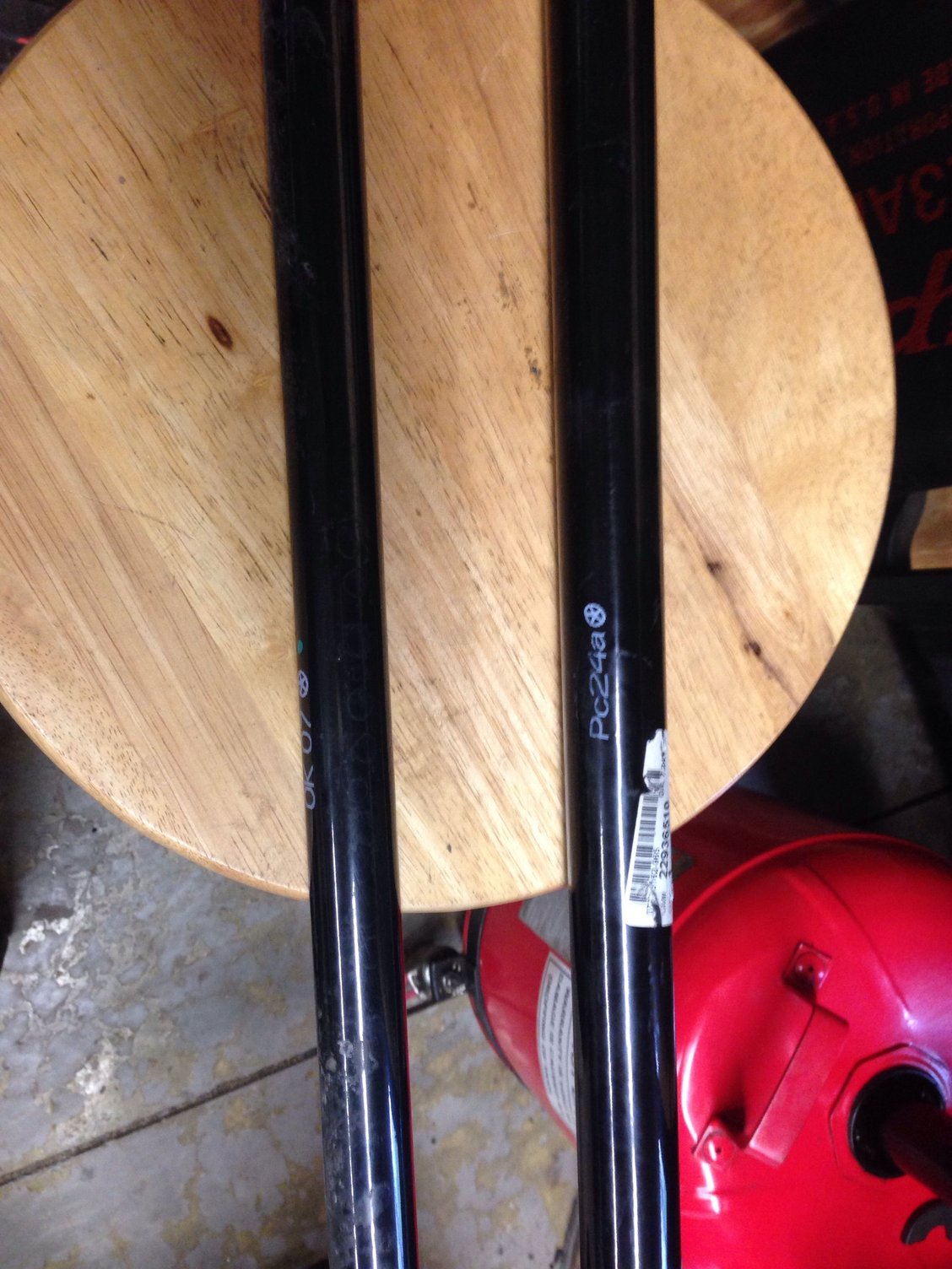

Here is the aFE/Pfadt variety to add to the mix - finally found the card with the un-boxing photos.
Still need to find the pictures of the micrometer readings, etc. today.
