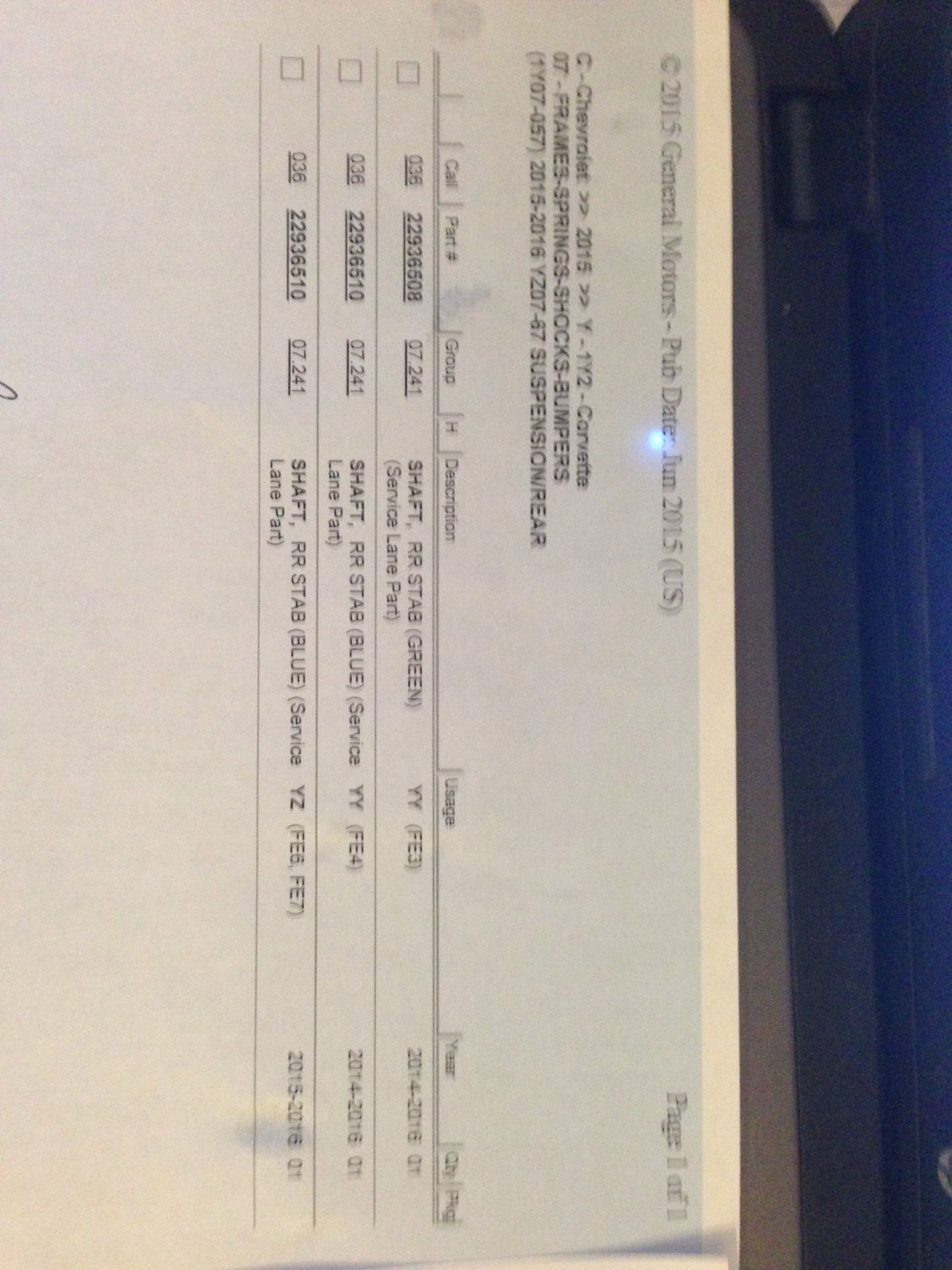

Old Jun 23, 2015 | 10:55 AM
savage's Avatar
savage
Joined: Jan 2014
Posts: 1,078
Likes: 262
From: swoyersville pa
as we can see the front sway bar is the same on the z51, z51 mag-ride, zo6, z07. but what is the last bar? dealer said he can not order that one as of now. also about the rear bars it looks like their is only two bars-mag ride or no mag ride
You are correct.
The Z51/Z06/Z07 all use the same front bar
The rear bar only change is non-mag Z51 then a mag ride Z51/Z06/Z07
This is why we did our bars....the car needed a bigger than what any of the factory cars were.
Yes our bars do use a stock bushing size, but the bar is way bigger than stock.
