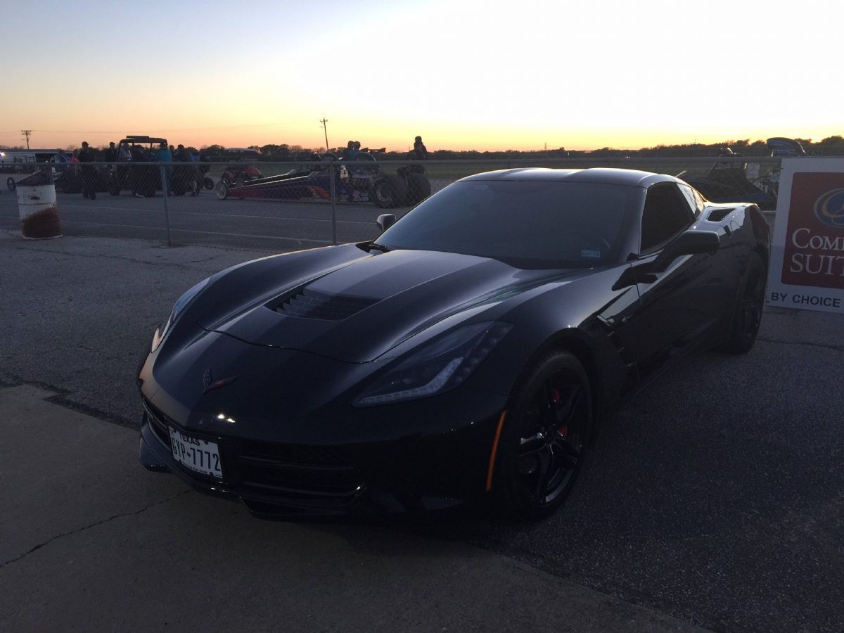

Ladies & Gentlemen, may I present Black Jack.
Since I started modding, I figured I'd start a thread to document my shenanigans.
2016 Stingray - Base 1LT - A8 - NPP
Enjoy.
