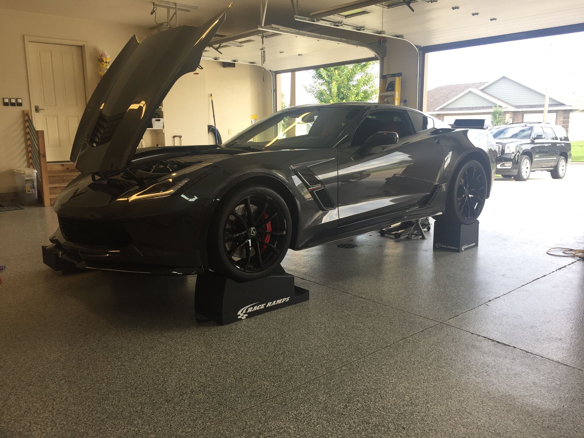

I did mine using race ramps in the front and some wooden blocks to keep the rear off the ground along with multiple jack stands to keep things safe. It was still low enough in the front to access components in the engine compartment:
