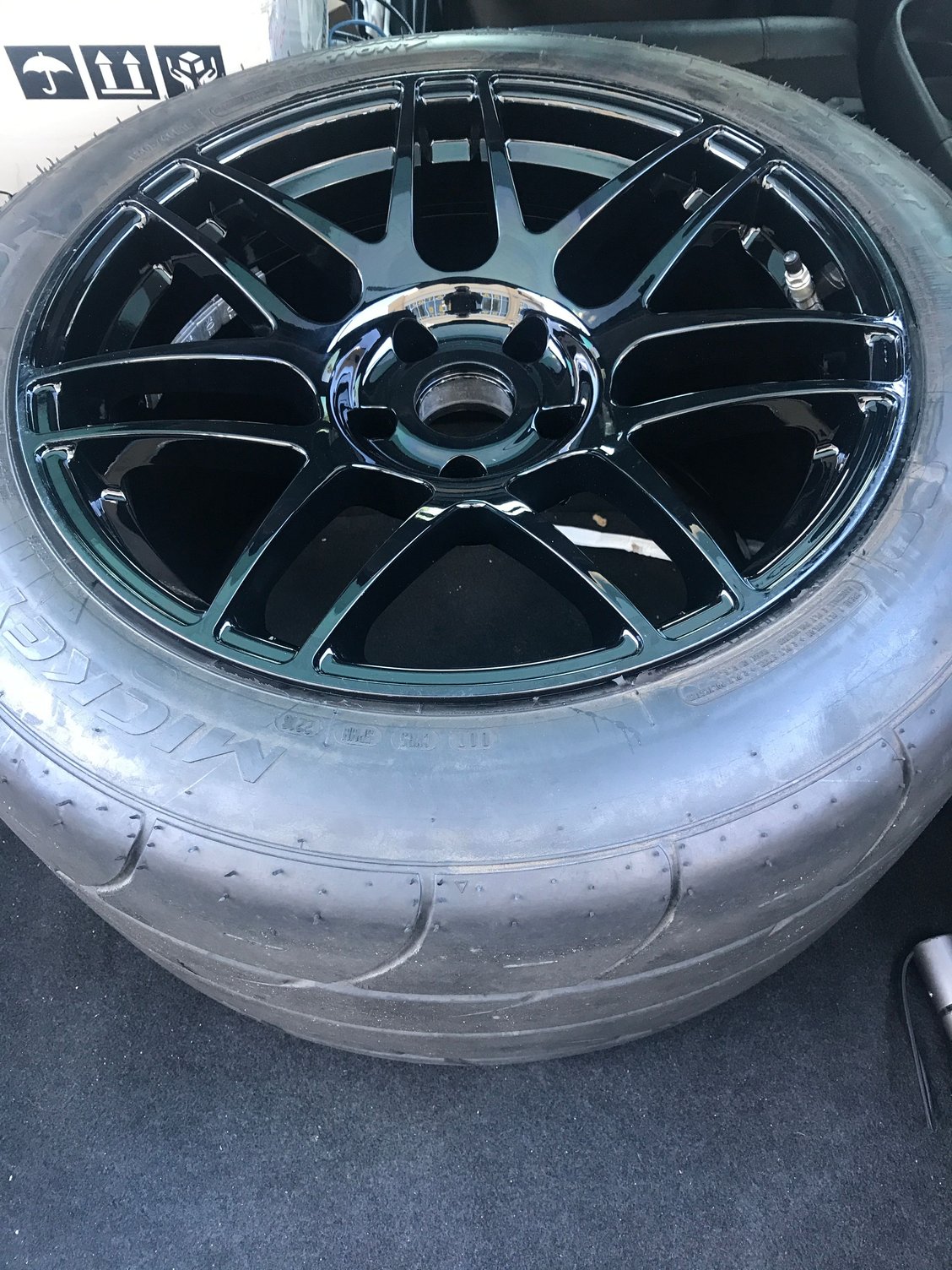

Got my 18"x12" rear Forgestars wrapped today with Mickey Thompson 305/40/18's. May mount them tonight..

Could you weigh it so we can keep track of different set ups?

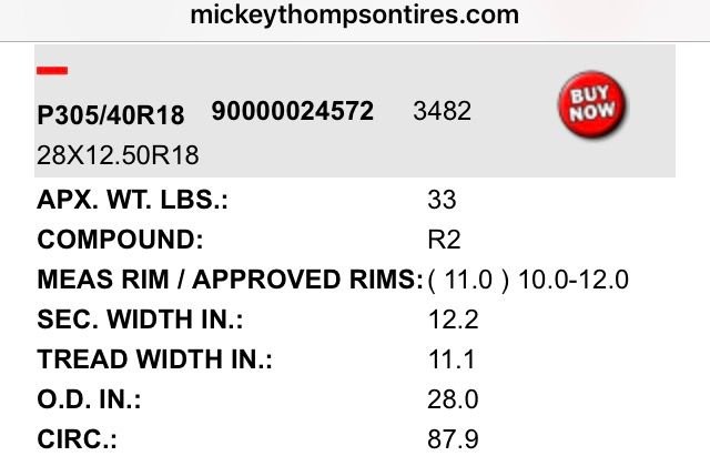

Total weight wheel and tire is 57.8 lbs. post 24 in this thread cites the weight of the rims alone at ~26 lbs. so that means the M/T tires are approx ~31.8 lbs.
Mickey Thompson specs (below) say the tires are approx ~33 lbs, so coming in at 31.8 lbs is pretty well spot on

Sweet...man look awesome lets see them on the car
My 18" replicas w hoosiers same weight btw
