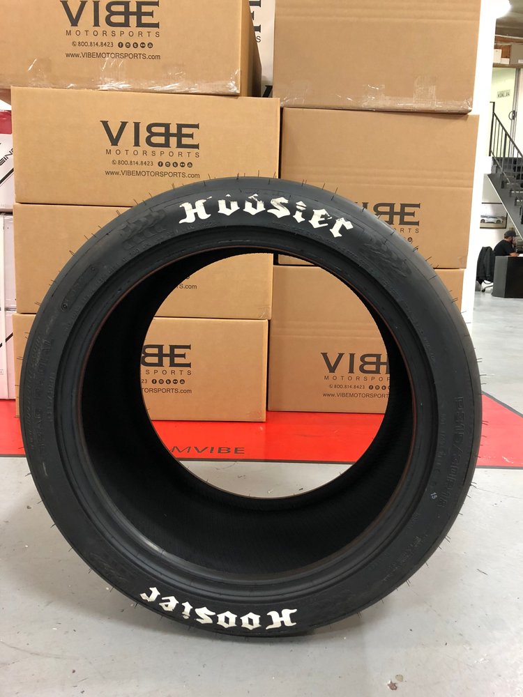

Hey Mike we got the tires in for you.
Correct,
The Forgestar Drag do required hub rings on all of the wheels.
78-70.3 is included with every order.
The rear we have options of F14 Model - 18x11 | 18x12 | 18x13
I think the 18x12 would be a very nice choice.

White letters on the inside please.

That's what i was also thinking..

Are those 315s or 335s
315=11" rim
335=12" rim
To me look like 315s...315s will stretch hard on 12" rim and almost impossible to inflate...found that out last week
