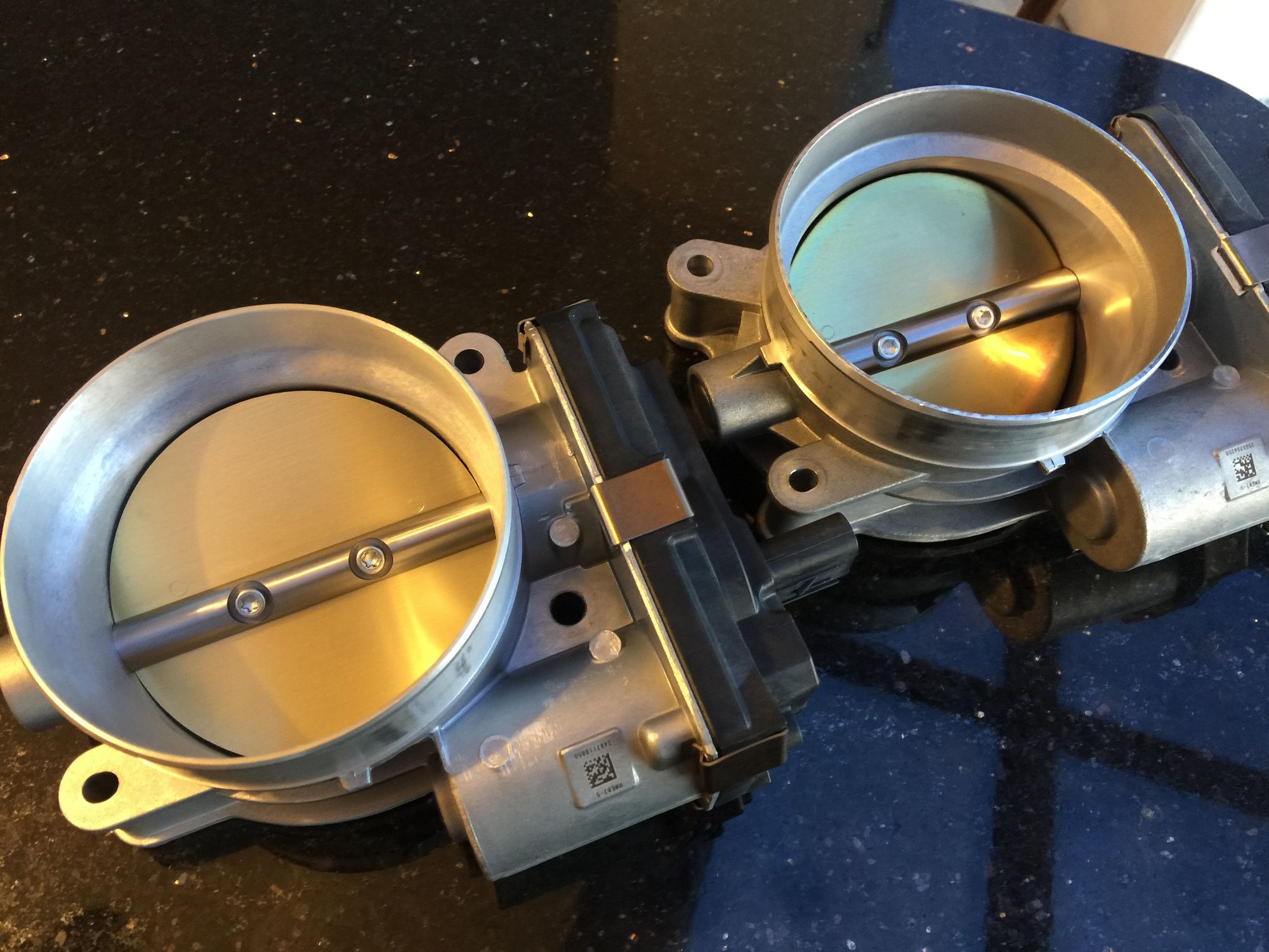

Stock cars will see a benefit. The throttle response is improved.
It’s a ten-minute swap. Stock is on right
