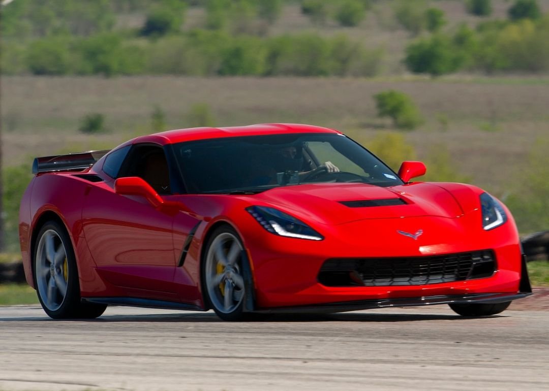

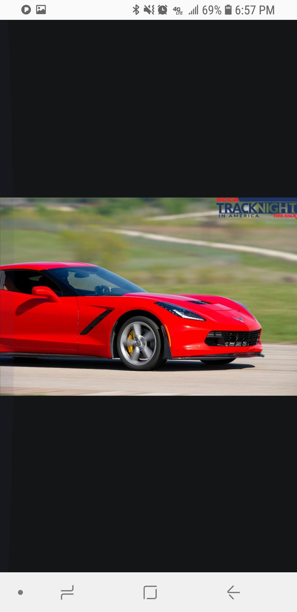

Old May 1, 2018 | 11:44 PM
joshuagtp56's Avatar
joshuagtp56
Cruising
Joined: Oct 2017
Posts: 13
Default side
this is what i mean by side of my car. and the are 18x10.5 TSW Nurburgring +65 5x120.65
and tires are. https://www.tirerack.com/tires/tires.jsp?tireMake=Bridgestone&tireModel =Potenza+RE-71R&sidewall=Blackwall&partnum=83WR8RE71 R&tab=Sizes
this is at 1.4 to 1.5 g

Old May 1, 2018 | 11:51 PM
joshuagtp56
Cruising
Joined: Oct 2017
Posts: 13
very light g load corner
