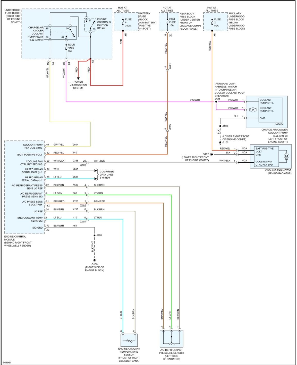

fyi... https://www.corvetteforum.com/forums...post1606573626
To Z06 fixed it self??
