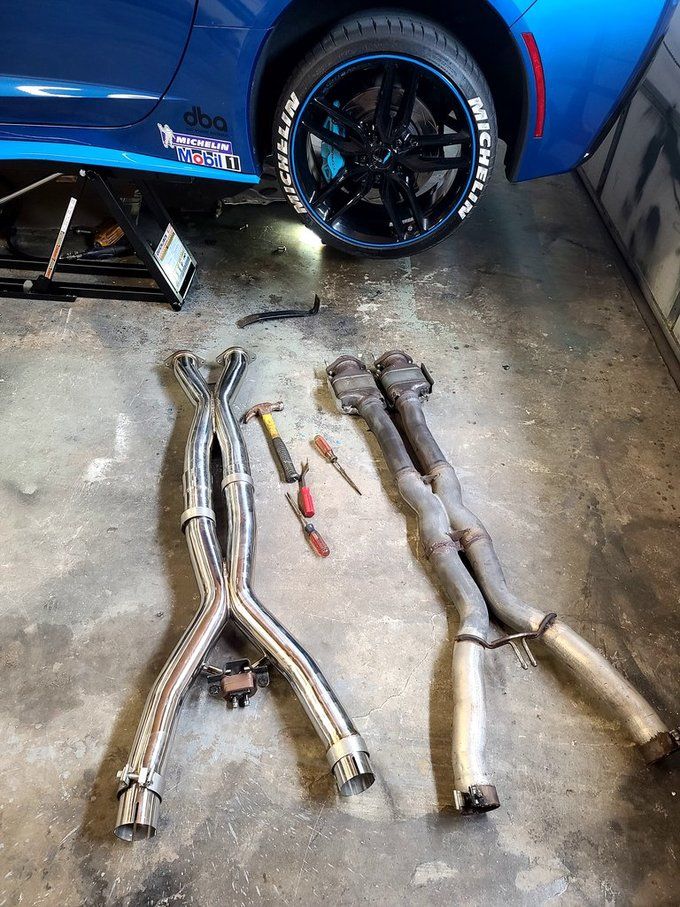

I still can't figure out how the EOS X-pipe connects. They say just bolt on. So what is it? Cut the old secondary cats and install them with the X-pipe or just bolt it on?
EDIT:
I finely found the picture I was looking for. Clearly the X-pipe is long enough to eliminate the sec CAT's. Ordered from Ebay $269 with free shipping.

it replaces the entire oem xpipe. you lose the oem secondary cats. I have this exact setup and also added the eos catless downpipes to have a full 3" system from the manifolds to the catback mufflers and zero cats. you dont cut any cats you remove them

It is a direct bolt on, you can reuse the donut gaskets from the Original X Pipe or purchase new ones. On the rear of the X pipe just sleeve the Clamp over the pipe on the muffler and bolt together.

I ordered the EOS from Ebay, the picture shows it comes with the donut gaskets and it's free shipping. It should be here this week.
This pipe comes in two pieces, I figured I would measure the original pipe and bolt the two together the same length.
