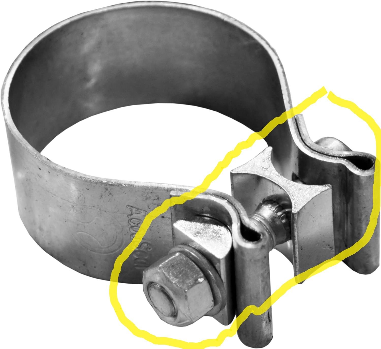

Also, as a reminder, when you put the clamps on to connect the two sections make sure the bolts are located on the top of the assembly. If not on top, then the bolts will hit the tunnel plate. Make sure you tightened them real good because you won't have access to them once you complete the installation.

It's not so much the bolt length, it is the highlighted portion of the clamp (pic below) that comes in contact with the tunnel plate. And there is not enough clearance between the pipes and the actual tunnel to have them on the side.

I would suggest you install the rear section first. use the small clamps. then the front section with the large clamps slid on before connecting the sections. you have to configure the clamps so 1 is on top and the other is at an angle you can tighten the nuts. no room for both on top. at the downpipes remove the springs that come with the kit the bolts aren't long enough to use the springs and get the nuts started. just leave them off.once everything is fitted then you can tighten it all down and have the needed length

What worked for me,,,, Stand both pipes up side by side and make the new two piece pipe match the original. It's important to match the length as well as how the two pieces line up. Tighten up the middle clamps and install it like a single piece pipe. The center clamps can be installed facing up and a bit to the inside so they don't rub against the outside of the tunnel.
