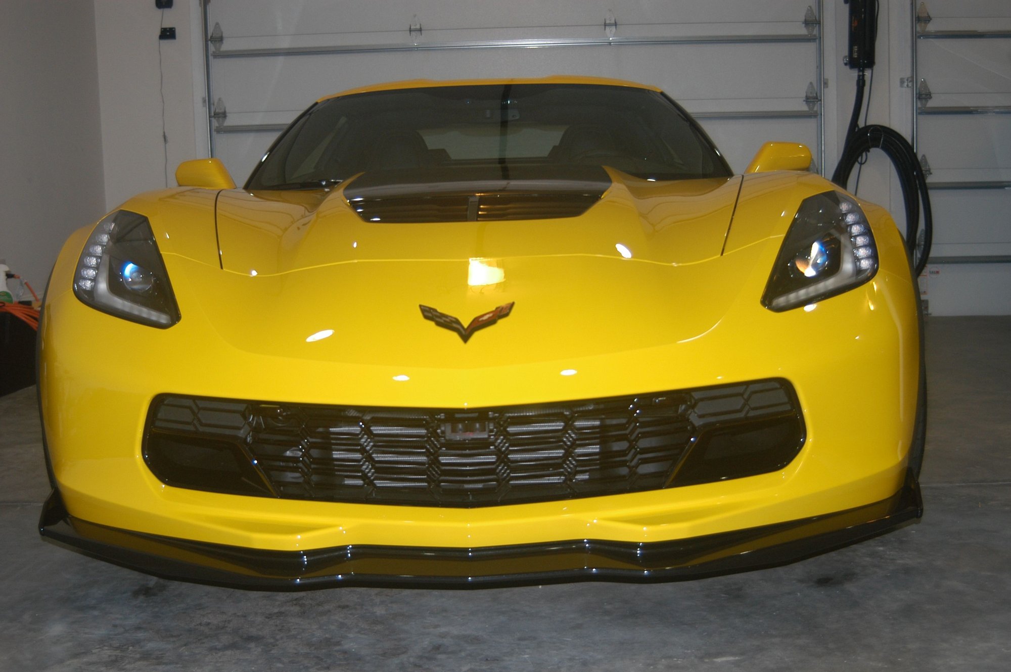

Any suggestions as to HOW to mount the front 2 heads in my stock grill on a 2016 C7 convertible? Looks like I will have to cut a space in the grill for the head, but theres nothing flat or sturdy to mount to with either the included metal clip from ALP or 3M adhesive tape. Has anyone encountered this and found a solution??

This thread shows how I mounted mine.
https://www.corvetteforum.com/forums...ont-grill.html

The grill in the z06 has openings that the stir+ will fit in. I mounted mine through the grill and it works great.

Here's what I was talking about
