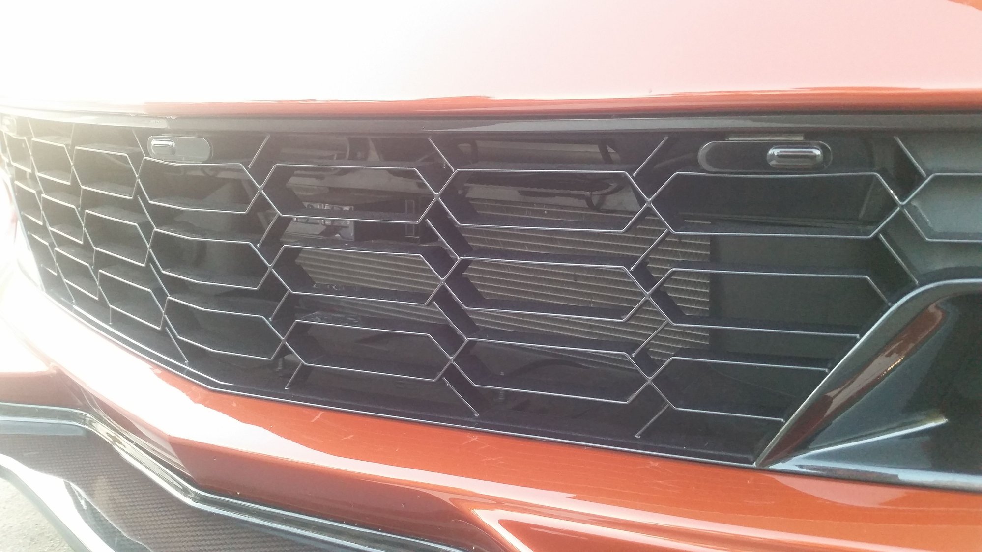

- Pic 1: Front Grill shot. You can see the 3 sensors and the big module in the middle behind the grill is the Beltronics STi-R Radar Add-On.

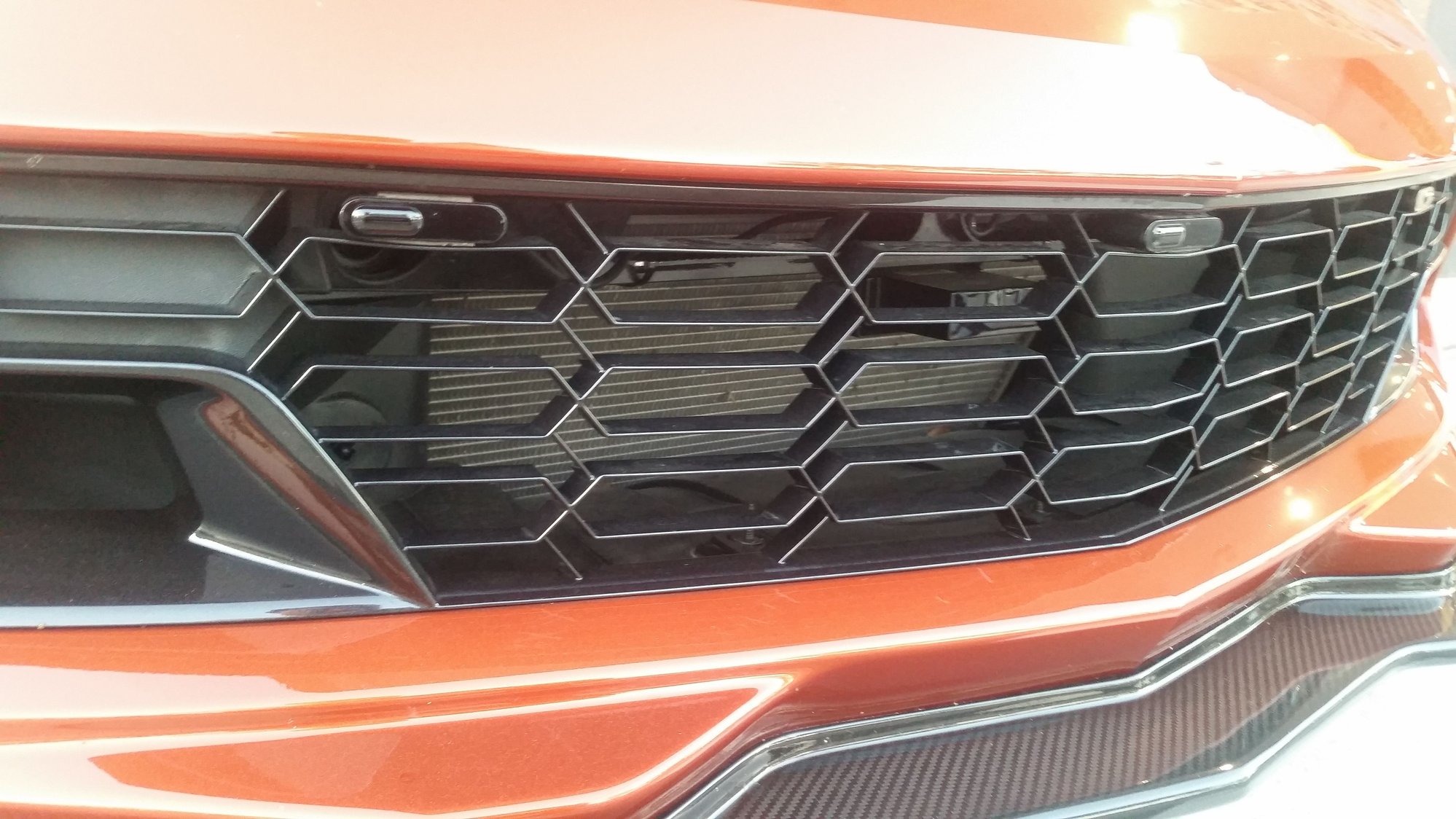

- Pic 2: Side Profile shot. Clearly shows the size of the Radar Add-On module.
- Pic 3: The other side.

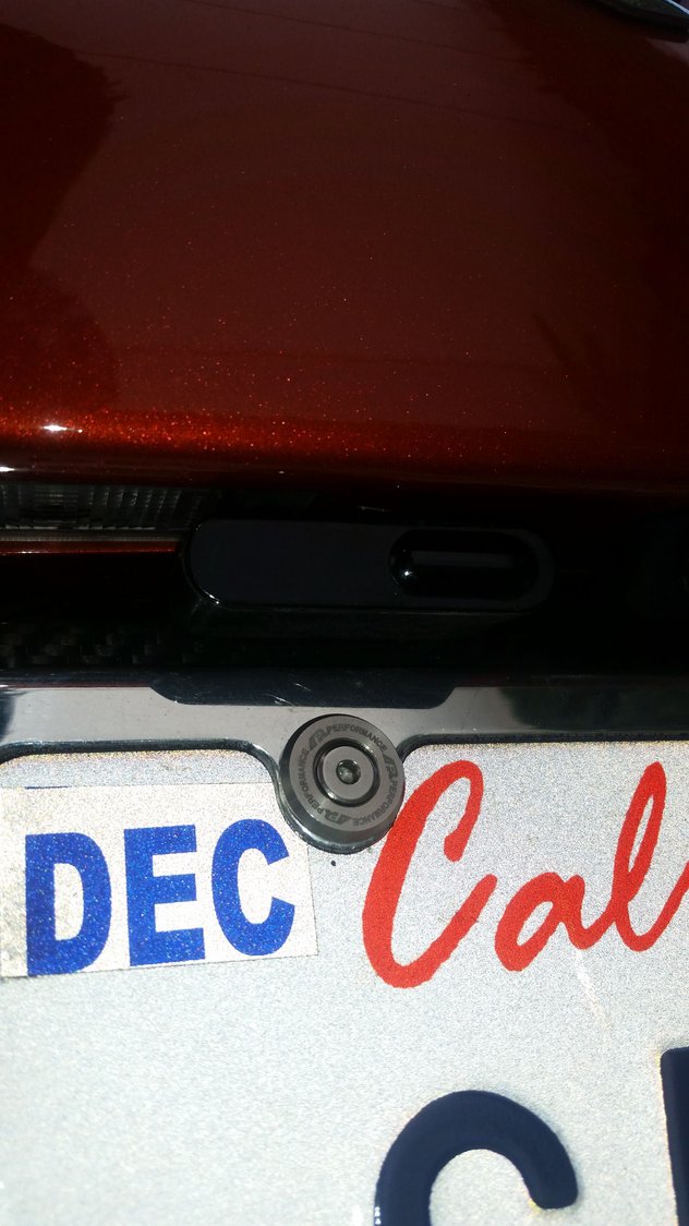

- Pic 4: The rear sensor. I had a tough time trying to get a pic. The sensor is just to the left of the rear camera above the lic. plate.

I don't think West Coast Corvette did a good installation nor offered you good advice. The problems I have with thier instsllation is as follows:
1. The Beltonics STiR+ radar receiver should not be placed behind a grill. Although radar signals will pass through plastic, the slats in the grill will change the radar waves resulting in significantly less range and possibly missing some radar signals.
2. One sensor on the resr of your vehicle will not offer you an acceptable level of protection, and for some LIDAR units that are heavily used in California namely the LTI Truspeed S, will offer you very little protection.
3. The front sensors should be mounted so they are pointing directly forward. Having the two side sensors pointing outward significantly decreases the ALP's effectiveness.

I went over the installation with ALP prior to and after WCC took the car in. The Beltronics add-on radar will pass through plastic. ALP themselves told me it was fine to install the detector behind any of the front plastic body pieces...completely covered. Plastic and rubber will allow the signals to pass through. Metal was a no-go!
I did not cover the placement of the sensors with ALP. The 2 side sensors are at an angle, but that can be fixed easily. I will readjust accordingly. The 3 front/2 rear setup was also discussed and ALP told me it was fine.

You can place the radar receiver behind a plastic body piece, but the piece it is behind must be flat and solid.
I have a little experiment you can do to simulate what is happening. takemyour index finger and thumb and hold then very close together, almost touching and hold them up to a light source. You will see little bands of dark and light as the light passes between your fingers. The dark is where the light is being bent and interfering with itself and canceling itself out. The light areas is where the light is not interfering with itself. This is what happens when you place the the radar receiver behind a grill. The grill bends the radar wave and can cause it cancel itself out.
Remember when you where a kid and you would shine a flash light through your hand or your fingers when closed together and you would srr the light transmit through your phone or fingers. This is similar with radar when it passes through a solid plastic (non metalic) object such as a flat bumper cover.

Congrats on purchasing the best performing laser jammer on the market but there is a reason we make these recommendations and by not following the recommendations you will actually leave yourself at risk against several of the more complicated guns.
It is a requirement that you use a minimum of 2 heads on each end of your vehicle to protect yourself against ALL guns on the market. Having 3 heads verse 2 on the front is fine but having only 1 on the rear will not fully protect your rear.
You can either have them move 1 head from the Front to the Rear as we recommended or add an additional head to the rear. For full protection your rear should look like this:
