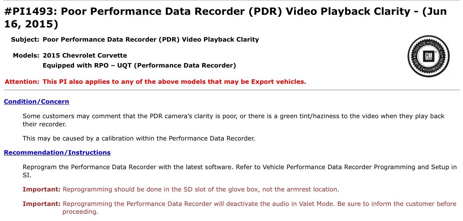

This kind of dicribes the poor image we are seeing so perhaps it's just a calibration issue as some have mentioned. This is an older bulletin, but was the only one under PDR/corvette/2014-2017 that I could find.

Old Feb 10, 2017 | 08:45 PM

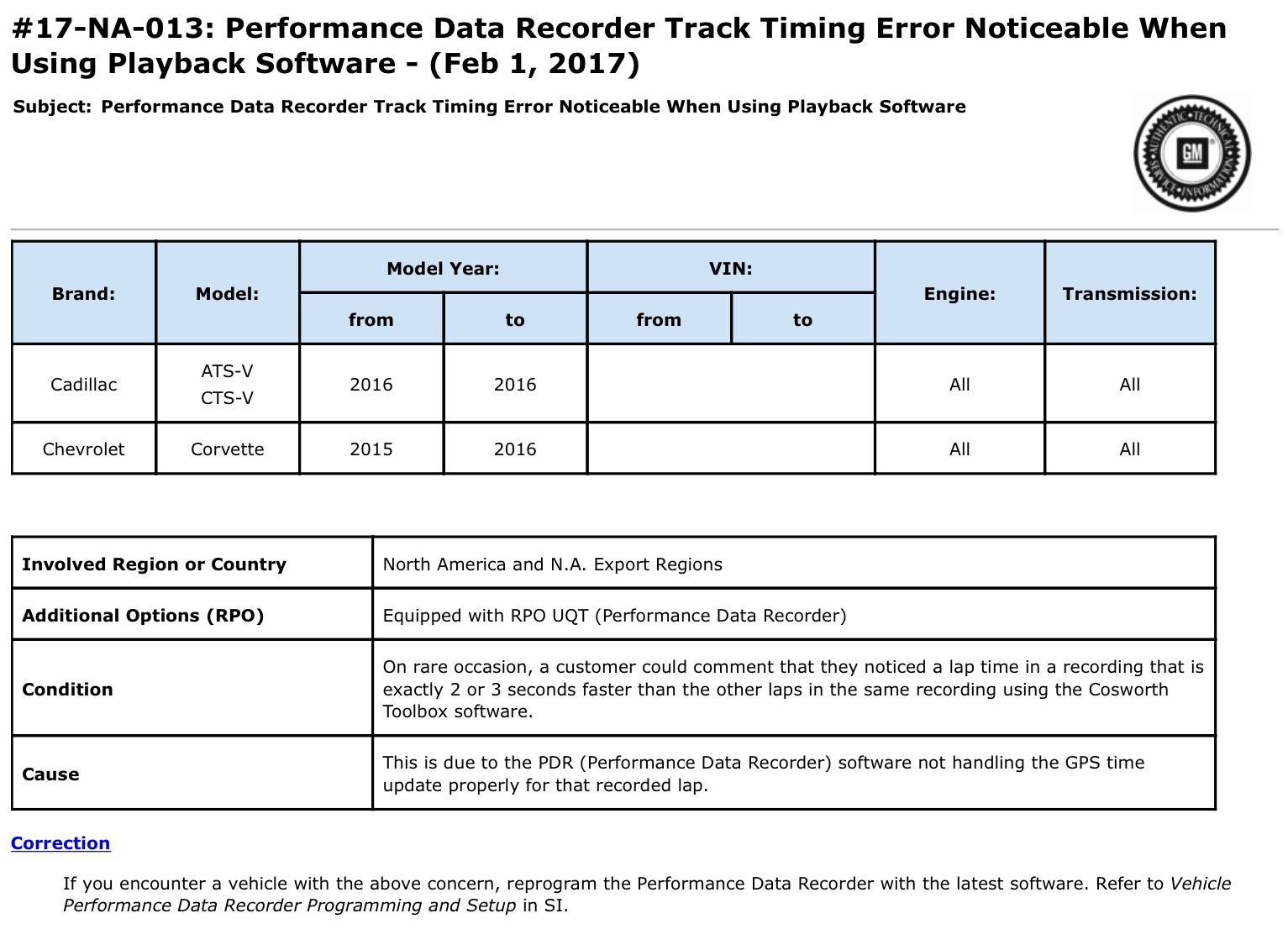

Oh and while we are on the subject I tripped across this as well.
Looks like I'm headed to the dealer. Finally a PDR timing fix.

Originally Posted by jvp
Right. This is the one Tadge told us about a year or two ago. All cars past that date should have come with that PDR cal.
The date says Feb 1 2017 and the timing issue bulletin impacts all 2015 and 2016 cars. Am I reading something incorrectly? I do recall Tadge discussing the issue a while back in the Ask Tadge. But by the dates it seems darn near everyone is affected and the timing fix is brand new.

I also had the Feb 1 update installed in my 2015. I haven't been to the track yet to see if the magic 2 seconds are gone but I can confirm that the overlay still looks like it always has on the 2015/16 cars.
I have a hard time understanding why GM would maintain two different software releases if there are no hardware differences between 2017 and prior years.
