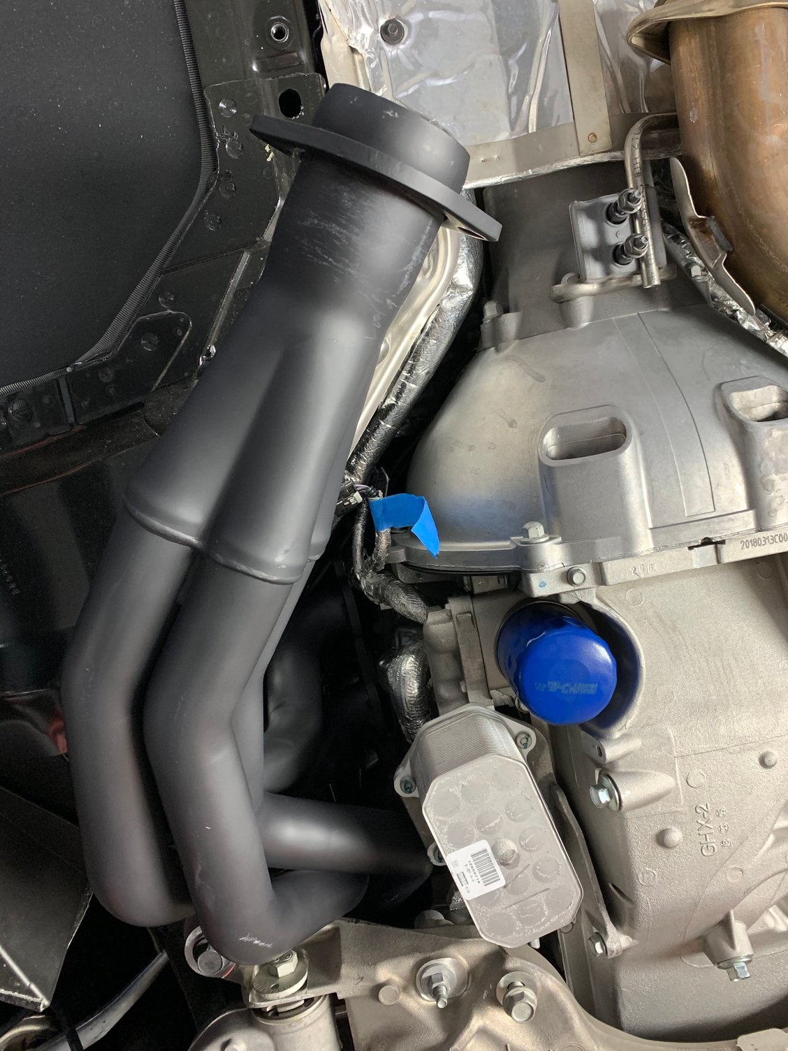

Old Aug 2, 2020 | 03:55 PM
  #33
MustOBeenYellow2015Z's Avatar
Joined: Jan 2015
Posts: 811
Likes: 177
This is how tight it is, lol
Old Aug 2, 2020 | 03:58 PM
  #34
badhabit_wb's Avatar
badhabit_wb
Joined: Sep 2014
Posts: 4,301
Likes: 959
From: in the country North Carolina
I forgot to tell you to take the steering shaft loose. I'm guessing you figured that one out. The other side might be a bit tighter...
